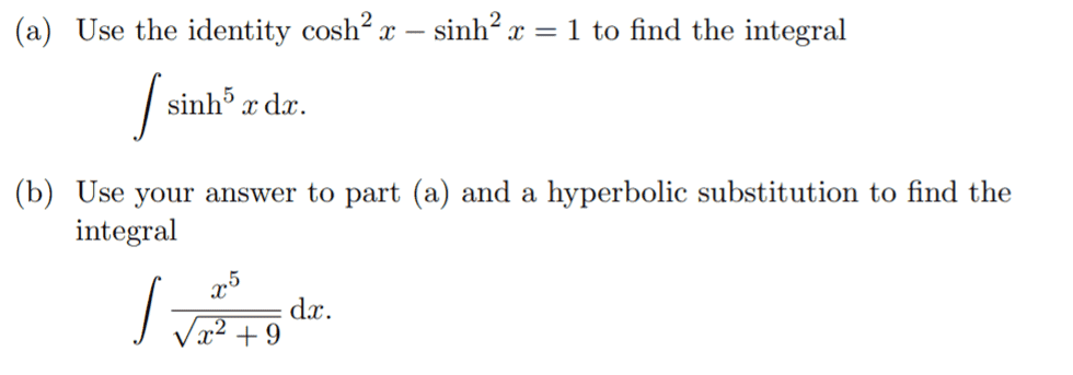

So the question is asking to solve an integral and to use the answer of that integral to find an additional integral. With part a, I don't have much problem, but then I don't know how to apply the answer from it to part b. I know I should subsitute all the x's in part b with a trig function, right? But which one? [/B]

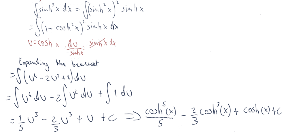

This is my solution for part a, I am not sure how to work on part b

You are replacing ##\sinh^2x## with ##1+\cosh^2x##. Check your algebra.
Also, the derivative of cosh(x) is sinh(x), not -sinh(x).
Likes Howard Fox
Okay, I tried to correct the previous mistakes,
Hope this one is good? Thank you
It is good. Look at part (a) and then look at part (b). What kind of hyperbolic substitution is worth trying in (b)?

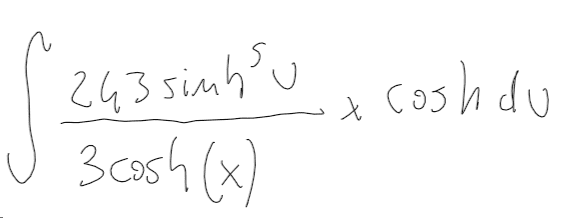

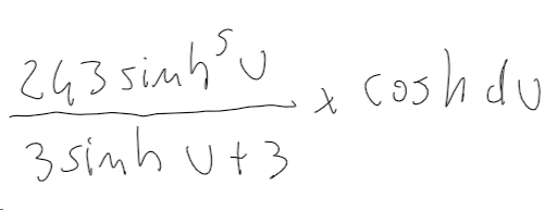

So the final integral should look something like this?
This does seem very complicated to solve though!
Howard Fox said:
It should be 3?
Yes.
That's because your algebra has been careless (again). Take the time to do it right. Then you will see that
(a) the denominator simplifies.
(b) you do not have a proper integral because you substituted ##1## for ##dx##.
(c) the numerator is incorrect.

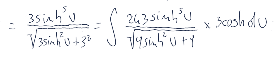

Uhm, is this any better?
Much better. Now concentrate on simplifying the denominator. How could you get rid of the radical? How does one usually get rid of a radical?

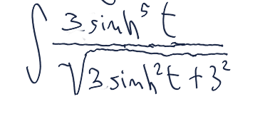

Just take the radical of the values like this?
Howard Fox said:
/View attachment 239813
Absolutely not ! Is ##\sqrt{2^2+1^2}=2+1=3~##?
