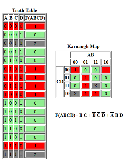

Wow I love you. Can I ask you a question. Suppose I am grouping and I had a pair of 1 & d next to each other.. I noticed on this particular problem my teacher gave us, he didn't group that pair, and thus; left out a term. My question is, if there is a grouping to be made of 1's. Why would you not make that grouping? Because that d can just be a 1 right? So why not group that? Wouldn't it minimize your cost? Isn't that the whole point! To find all groupings? Otherwise aren't you missing something? Example Below. We are dealing with Sum of Products by the way just FYI.. NOTE: The x's are my don't cares or "d"s
It isn't always advantageous to make a 'd' a '1'. Clumping on K-maps works like this: they always have to be contiguous rectangles (they can wrap around, both horizontally and vertically), where the height and width are powers of 2. In your case, the 'd' in the $ABCD$ location allows you to form the more efficient term $BC$. However, the 'd' in the $ \bar{A} \bar{B}C \bar{D}$ position does not allow you to form a contiguous rectangle of width a power of 2 and height a power of 2 that includes any ones you can't already get from a different grouping. That is, the '1' in the $\bar{A} \bar{B} \bar{C} \bar{D}$ position you've already got from $\bar{B} \bar{C} \bar{D}$, and the '1' in the $\bar{A}BC \bar{D}$ position you've already gotten from the $BC$ term.
Leaving out minterms is the whole point; it makes the resulting Boolean expression smaller. I agree with Adrian's explanation. If grouping a d with 1's leads to a bigger group (and thus smaller minterm) whose width and height are powers of 2, then it's a good thing; otherwise it's better to leave it as 0.
