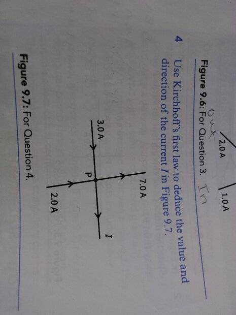

Use Kirchhoff's law to deduce the value and direction of the current I.
Current entering a point is equal to current exiting a point
3 A+ 2 A = 7 A+ I
I = -2A
How the current can be in negative direction? If the sign if negative, doesn't it mean that the current will move towards the point P? Also If I am taking the 2A to be positive then Kirchhoff's law isn't satisfied as 5A≠7A

haha0p1 said:
Because The question is asking to find value of I which is coming 2
##I \ne 2## as you yourself have already established. And, you seem to know that ##I = -2## but have decided that current must be positive. That puts you in an impossible position in this case.
think of it this way:
If you designate a current leaving a node as positive and it mathematically turns out negative via KCL then that current is actually entering.
What’s really happening is that
3A is entering from the right
2A is entering from the bottom
2A is entering from the left
7A is leaving from the top
Likes haha0p1 and PeroK
