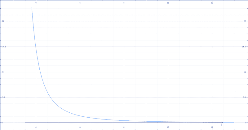

Thus we now have an expression that will tell us the external magnetic field, for a solenoid of radius r, internal field strength Bsol at distance X. Graphing that with Bsol = 25T and r = 3m gives us:
One can see that VERY significant magnetic fields would exist within several meters of the solenoid. A half Tesla magnetic field would exist 5 meters from the solenoid. Were the solenoid literally part of the exterior hull, that would mean that, at the hull(assume .25meters), we’d have a field of 278 Tesla. Let’s calculate the turning radius of a proton under those conditions:

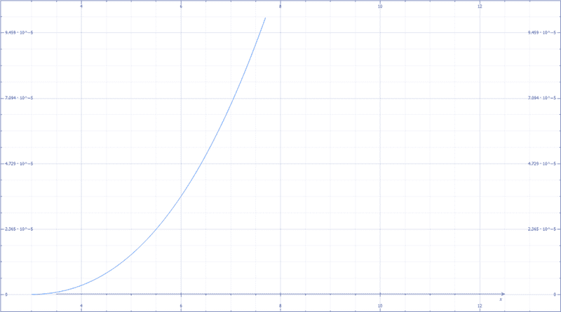

r_turning=mv/(q 〖r_sol〗^2/π B_sol ( 2x + r_sol )〖(x+r_sol )〗^(-2) 〖( x–r_sol )〗^(-2) )
We can now further see that particles coming with 10m of the craft will have a turning radius on the order of .1 mm. 5 meters from the hull the turning radius of particles is .13mm.
