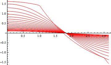

If one boundary is insulated and the other is subjected to and held at a temperature of unity, we wish to determine the solution for the transient heating of the slab.
The governing equation is the usual 1-D heat equation and the boundary conditions (mixed) are given by
\begin{alignat*}{3}
T_x(0,t) & = & 0\\
T(L,t) & = & 1
\end{alignat*}
with initial conditions
T(x,0) = 0.
Obtain the solution to this problem.

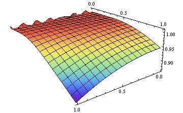

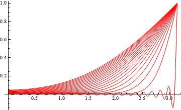

For the special case $\alpha = 1$ and $L = \pi$ plot a sequence of the temperature profiles between the initial state and the steady-state, construct a contour plot, density plot, and 3D plot.
Once we solve the problem, we obtain the solution as
T(x,t) = 1 + \frac{4}{\pi}\sum_{n = 1}^{\infty}\frac{(-1)^n}{2n - 1}\cos\left[\left(n - \frac{1}{2}\right)x\right]\exp\left[-\left(n - \frac{1}{2}\right)^2t\right]
Next, we construct all the plots using Mathematica
Code:
Nmax = 40;
L = Pi;
\[Lambda] = Table[(n - 1/2)*Pi/L, {n, 1, Nmax}];
\[Alpha] = 1;
MyTime = Table[t, {t, 0.0001, 1, .05}];
f[x_] = -1;
A = Table[2/L*Integrate[f[x]*Cos[\[Lambda][[n]]*x], {x, 0, L}], {n, 1,Nmax}];
u[x_, t_] = 1+Sum[A[[n]]*Cos[\[Lambda][[n]]*x]*E^{-\[Alpha]*\[Lambda][[n]]^2*t}, {n, 1, Nmax}];
Plot[u[x, MyTime], {x, 0, L}, PlotStyle -> {Red}]
This will produce the graph
https://www.physicsforums.com/attachments/390._xfImport
Adding in this piece of code will produce an animation between the different time profiles.
Code:
Animate[Plot[u[x, t], {x, 0, L}, PlotRange -> {0, 1.1}, GridLines -> Automatic, Frame -> True, PlotStyle -> {Thick, Red}], {t,0, 1, 0.02},
 AnimationRunning -> False]

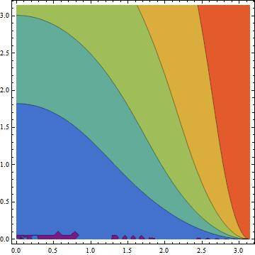

We can produce the contour plot by adding in
Code:
ContourPlot[u[x, y], {x, 0, L}, {y, 0, L}, PlotRange -> All, ColorFunction -> "Rainbow"]
The end result is
https://www.physicsforums.com/attachments/393._xfImport

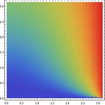

The density plot
Code:
DensityPlot[u[x, y], {x, 0, L}, {y, 0, L}, PlotRange -> All, ColorFunction -> "Rainbow"]
The plot is
https://www.physicsforums.com/attachments/392._xfImport

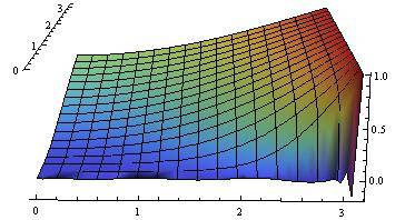

And lastly the 3d plot
Code:
Plot3D[u[x, y], {x, 0, L}, {y, 0, L}, PlotRange -> All, Boxed -> False, ColorFunction -> "Rainbow"]
https://www.physicsforums.com/attachments/391._xfImport
Here we can see the Gibbs Phenomenon occurring.

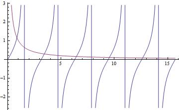

With this problem, let's identify the first 40 eigenvalues and construct the same plots.
In solving this problem, we have that the eigenvalues are
\tan\lambda_n = \frac{1}{\lambda_n}.
Code:
Nmax = 40;
MyTime = Table[t, {t, 0.0001, 4, .2}];
f[x_] = 1;
Plot[{Tan[x] , 1/x}, {x, 0, 5 Pi}]
Here we can look at the plot of the solution to $\tan\lambda_n = \frac{1}{\lambda_n}$.
Now, let's find the first 40 eigenvalues numerically.
Code:
\[Lambda] = Flatten[Table[FindRoot[Tan[x] - 1/x == 0, {x, (n - 1/2)*\[Pi] - 0.0001}], {n, Nmax}]][[All, 2]]
{0.860334, 3.42562, 6.4373, 9.52933, 12.6453, 15.7713, 18.9024,

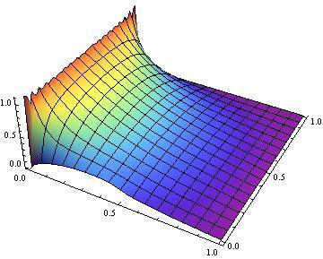

Next is our 3d plot
Code:
Plot3D[u[x, y], {x, 0, 1}, {y, 0, 1}, PlotRange -> All, Boxed -> False, ColorFunction -> "Rainbow"]

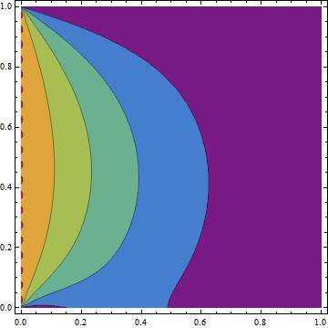

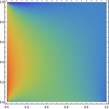

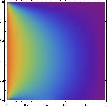

Consider Laplace's equation $\nabla^2u = 0$ on the rectangle with the following boundary conditions:
u_y(x,0) = f(x)\quad u(L,y) = 0\quad u(x,H) = 0\quad u(0,y) = g(y).
Evaluate the series coefficients for the particular case of $f(x) = g(y) = 1$ and plot a contour map of $u(x,y)$ assuming $L = H = 1$.
So the solution is
u(x,y) = \frac{4}{\pi}\sum_{n = 1}^{\infty}\left[\frac{\sin(2n - 1)\pi x\sinh\left[\pi(2n - 1) (1 - y)\right]}{\pi(2n - 1)^2\sinh\left[(2n - 1)\pi\right]} + \frac{\sin(2n - 1)\pi y\sinh\left[(2n - 1)\pi(1 - x)\right]}{(2n - 1)\sinh\left[(2n - 1)\pi\right]}\right].
Let's use Mathematica to produce the desired plots.
Code:
Nmax = 40;
L = 1;
H = 1;
\[Lambda] = Table[(n*Pi)/L, {n, 1, Nmax}];
f[x_] = 1;
g[y_] = 1;A = Table[2/(L*\[Lambda][[n]]*Cosh[\[Lambda][[n]]*H])*Integrate[f[x]*Sin[\[Lambda][[n]]*x], {x, 0, L}], {n, 1, Nmax}];
B = Table[2/(L*Sinh[\[Lambda][[n]]*H])*Integrate[g[y]*Sin[\[Lambda][[n]]*y], {y, 0, H}], {n, 1, Nmax}];
u[x_, y_] = Sum[A[[n]]*Sin[\[Lambda][[n]]*x]*Sinh[\[Lambda][[n]]*(H - y)] + B[[n]]*Sin[\[Lambda][[n]]*y]*Sinh[\[Lambda][[n]]*(L - x)], {n, 1, Nmax}];
DensityPlot[u[x, y], {x, 0, L}, {y, 0, H}, PlotRange -> All, ColorFunction -> "Rainbow"]

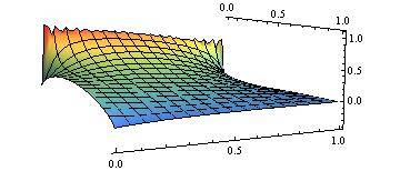

Code:
Plot3D[u[x, y], {x, 0, L}, {y, 0, H}, PlotRange -> All, Boxed -> False, ColorFunction -> "Rainbow"]
Code:
ContourPlot[u[x, y], {x, 0, L}, {y, 0, H}, PlotRange -> All, ColorFunction -> "Rainbow"]

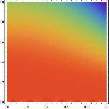

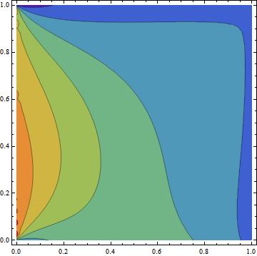

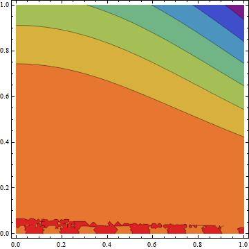

Let's consider the problem we just did. What if $f(x)$ was defined
Code:
Nmax = 40;
L = 1;
H = 1;
f[x_] = Piecewise[{{1, x < L/2}, {0, x > L/2}}];
Code:
Code:
