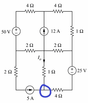

In summary, @Bright Liu has identified that his ground node is at the bottom, and that if you follow the left path from 0 potential point to point V_1, you will have to cross through a 2 ohm resistor and move in the opposite direction of current.

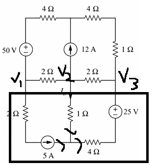

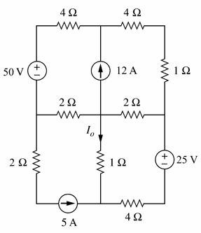

Solve for current I0 using nodal analysis.
Hi all,
Managed to get an answer out, but unfortunately, it doesn't correspond with the answer given ( –3.09 A)

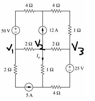

Would appreciate if one could check out what I did wrongly here:
## V_{1}=2\times 5=10V ##
At node 2:
## \dfrac{V_{1}-V_{2}}{2}=12+\dfrac{V_{2}}{1}+\dfrac{V_{2}-V_{3}}{2}##
We can also see that:
## \dfrac{V_{2}}{1}+5=\dfrac{25-V_{3}}{4} ##
May I know if any of my equations are wrong? If so, what seems to be the problem?
Thanks

I think he has defined this node as ground node
I think you are right and the answer is wrong

As quoted by @Bright Liu, my ground node will be at the bottom.

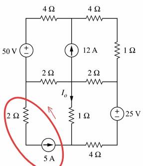

I think it is right as if we start moving from 0 potential point to point ##V_1## through left path then we have to cross through 2 ohm resistor and we are moving opposite to current so potential difference should be positive and equal to 10 volts by ohm's law.

So no voltage across the 5A current source? :wink:
Maybe I am missing some point🤔,
This is what I am considering
The 5A and 12A shown in the diagram are current sources. They are circuit elements just like voltage sources and resistors. There will be some voltage drop across them too.
You haven't considered that in your reasoning.

I am so stupid,I thought it is an ammeter😅 but after searching,it comes out to be some different thing.
So I learned something new today.

Hmm if there is a voltage drop across the current source, what equation can I craft at node 1 then? Pretty confused by this.
cnh1995 said:
No need to feel that way in a scientific discussion:smile:.
And circuits are tricky! There is always room for silly mistakes.
Ooh EDIT: nvm i got it, just had to craft out 4 equations for 4 nodal points =-=
