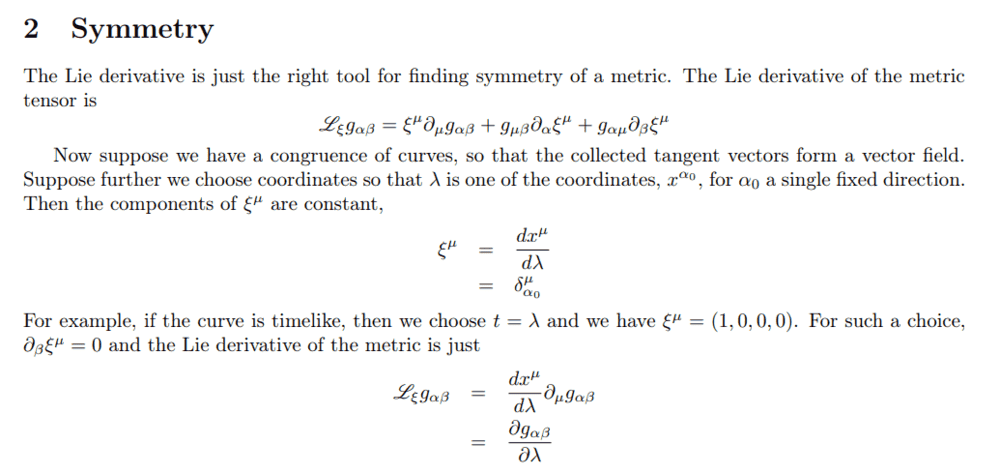

This is from my GR lecture notes:

As for Noether’s theorem, it states that if ##q^a \to q^a + \epsilon k^a## is a symmetry of the Lagrangian, then ##p_a k^a## is a constant of motion. There is only one term here but note that, due to the summation convention, it is a linear combination of the canonical momenta. Also note the index placements.

OK so it is going to be a Killing vector field.
Suppose we have a collection of curves, so that the collected tangent vectors form a Killing vector field. I've read that we can choose coordinates so that ##\lambda## is one of the coordinates, ##q^{a_1}##, for ##a_1## a single fixed direction. Let us define ##\xi = \frac{d}{d \lambda}##. Then:
$$\xi^j = \frac{d (q^a)^j}{d \lambda} = \delta_{a_1}^{j}$$
But this is what I have done above...
This is coming from here:
More details: http://www.physics.usu.edu/Wheeler/GenRel2013/Notes/GRKilling.pdf
