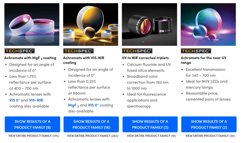

Hello everyone,
I want to choose a lens, but i am confused about the lens type. I know that chromatic and spheric lenses cause Aberration. So my Choice will be either aspheric or achromatic lens. Since acromatic lens consists of two lenses, it is no thin lens anymore. Or am I wrong about that ? An AFM Probe should be imaged, so the image will be in micro range.
The Light is 450 nm, Please help me how to choose the right one ? Here is a Screenshot of a few achromatic lenses. According to which criteria should the choice be ?
Best regards
There may be some language issues (so apologies if I misunderstand).
Lenses intrinsically have deviations from ideal behaviour. One cannot eliminate all these aberrations but can minmize a chosen subset. That choice is determined by the design criteria for the optical system. You have given (to me at least) no exact idea what you are trying to do.

I would like to image a measuring probe using a CCD camera. A simple lens is used instead of an objective. Spherical and chromatic lenses have an aberration. The cantilever is 50 µm wide and should be imaged sharply with its surroundings. The light used is 450 nm and is emitted diffusely. The light radiation is reflected by two white umbrellas. I need help choosing the focal length and lens shape or aperture? There are many choices of suppliers based on the coating and the light used. Does the coating play a role in this context?
My Idea :
Since the cantilever is 50 µm wide, the optimal lateral image magnification is 4 to 8. Accordingly, according to the lens maker equation with an object distance of 110 nm (large for deflection via deflection mirrors) the focal length will be 88 to 97.8 mm. To avoid spherical or chromatic aberrations, I would like to use either an aspheric or achromatic lens. The light is emitted diffusely from the side of the camera and is evenly reflected by 2 white umbrellas.
Object distance 110 nm?
If you have essentially monochromatic light why worry about chromatic aberration?
If you need an image why not use a "regular" camera lens? Is the camera homebuilt? If you need a large depth of field you need a lower f-number lens (and therefore sufficient illumination.) Silicon is not very sensitive to violet
Looks to me like number 4 in the Edmund line up might be best with that illuminant. You may need to "stop down" the lens to get the desired depth of field. Are there speed (frame rate/exposure time) requirements? When doubt build it up on the bench: Edmund is a fast (but not cheap) supplier of good stuff. Good luck.
