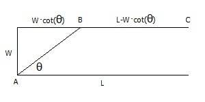

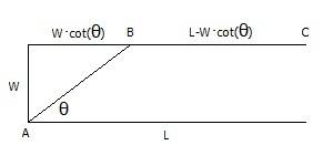

On another forum the following question was asked:
If a prisoner can swim at a rate of 6 fps and run at a rate of 12 fps, what angle should the prisoner take to escape as fast as possible? He's going across a river. The distance upstream to the safehouse is 10000 feet and the river is 2000 feet wide. Thanks Everybody! :D
This was my initial reply:
Let:
$L$ = distance upstream to the safehouse
$W$ = width of the river
$v_s$ = swimming speed
$v_r$ = running speed
All variables above are assumed to be positive.
I have set it up as follows:
https://www.physicsforums.com/attachments/2775._xfImport
The prisoner swims from A to B and runs from B to C. The distance from A to B is:
[math]AB=W\csc(\theta)[/math]
The time this takes is:
[math]t_s=\frac{W}{v_s}\csc(\theta)[/math]
The distance from B to C is:
[math]BC=L-W\cot(\theta)[/math]
[math]t_r=\frac{1}{v_r}(L-W\cot(\theta))[/math]
The total time then is:
[math]t=t_s+t_r=\frac{W}{v_s}\csc(\theta)+\frac{1}{v_r}(L-W\cot(\theta))[/math]
[math]\frac{dt}{d\theta}=-\frac{W}{v_s}\csc(\theta)\cot(\theta)+\frac{W}{v_r}\csc^2(\theta)=W\csc(\theta)\left(\frac{1}{v_r}\csc(\theta)-\frac{1}{v_s}\cot(\theta) \right)=0[/math]
Observing [math]\csc(\theta)\ne0[/math] for all real $\theta$, we then use:
[math]\frac{1}{v_r}\csc(\theta)-\frac{1}{v_s}\cot(\theta)=0[/math]
[math]\csc(\theta)\left(\frac{1}{v_r}-\frac{1}{v_s}\cos(\theta) \right)=0[/math]
[math]\frac{1}{v_r}-\frac{1}{v_s}\cos(\theta)=0[/math]
[math]\cos(\theta)=\frac{v_s}{v_r}[/math]
[math]\theta=\cos^{-1}\left(\frac{v_s}{v_r} \right)[/math]
This is why I used variables, so we can make a few observations:
(1) the angle is independent of $L$ and $W$. We do however require:
[math]\tan^{-1}\left(\frac{W}{L} \right)\le\theta\le\frac{\pi}{2}[/math]
(2) If [math]v_s=v_r[/math] then:
[math]\theta=\cos^{-1}(1)=0[/math]
However, with $\theta=0$, the prisoner will not cross the river. So, what then is minimum ratio of [math]\frac{v_s}{v_r}=k[/math] which causes the prisoner to swim straight for the safehouse, in other words, to swim the entire distance? We may set the distance BC to zero:
[math]L-W\cot(\theta)=0[/math]
[math]\cot(\theta)=\frac{L}{W}[/math]
[math]\cot\left(\cos^{-1}\left(\frac{v_s}{v_r} \right) \right)=\frac{L}{W}[/math]
[math]\frac{v_s}{\sqrt{v_r^2-v_s^2}}=\frac{L}{W}[/math]
[math]\frac{kv_r}{\sqrt{v_r^2-(kv_r)^2}}=\frac{L}{W}[/math]
[math]\frac{k}{\sqrt{1-k^2}}=\frac{L}{W}[/math]
[math]k=\frac{L}{\sqrt{W^2+L^2}}[/math]
Thus if [math]v_s\ge\frac{L}{\sqrt{W^2+L^2}}v_r[/math] then the prisoner should swim the entire way.
(3) As [math]k\to 0[/math] then [math]\theta\to\frac{\pi}{2}[/math].
Plugging in the data given to finish the problem, we have:
[math]\theta=\cos^{-1}\left(\frac{6\text{ fps}}{12\text{ fps}} \right)=\cos^{-1}\left(\frac{1}{2} \right)=\frac{\pi}{3}=60^{\circ}[/math]
This is a valid angle as it satisfies:
[math]\tan^{-1}\left(\frac{1}{5} \right)\le\theta\le\frac{\pi}{2}[/math]

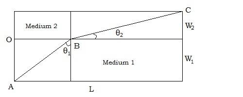

Let's generalize a bit to say we want to find the quickest path across two media:
https://www.physicsforums.com/attachments/2776._xfImport
We are traveling from point A to point B then to point C by the quickest path possible. The question is, where should point B be placed?
I have set up $xy$ coordinate axes such that:
[math]O=(0,0)[/math]
[math]A=(0,-W_1)[/math]
[math]B=(B,0)[/math]
[math]C=(L,W_2)[/math]
[math]AB=\sqrt{(B-0)^2+(0-(-W_1))^2}=\sqrt{B^2+W_1^2}[/math]
[math]BC=\sqrt{(L-B)^2+(W_2-0)^2}=\sqrt{(L-B)^2+W_2^2}[/math]
The speed through medium 1 is $v_1$ and the speed through medium 2 is $v_2$. We assume both velocities are positive values. Thus, using the relationship between distance, constant velocity and time, we find the total time as a function of B is:
[math]t(B)=\frac{\sqrt{B^2+W_1^2}}{v_1}+\frac{\sqrt{(L-B)^2+W_2^2}}{v_2}[/math]
Differentiating with respect to B, we find:
[math]t'(B)=\frac{B}{v_1\sqrt{B^2+W_1^2}}+\frac{(B-L)}{v_2\sqrt{(L-B)^2+W_2^2}}=\frac{Bv_2\sqrt{(L-B)^2+W_2^2}+(B-L)v_1\sqrt{B^2+W_1^2}}{v_1v_2\sqrt{B^2+W_1^2}\sqrt{(L-B)^2+W_2^2}}[/math]
The denominator will always be positive, so we need only consider:
[math]Bv_2\sqrt{(L-B)^2+W_2^2}+(B-L)v_1\sqrt{B^2+W_1^2}=0[/math]
[math]Bv_2\sqrt{(L-B)^2+W_2^2}=(L-B)v_1\sqrt{B^2+W_1^2}[/math]
Let's take a moment to rewrite this:
[math]\frac{B}{\sqrt{B^2+W_1^2}}\cdot\frac{\sqrt{(L-B)^2+W_2^2}}{L-B}=\frac{v_1}{v_2}[/math]
[math]\frac{\frac{B}{\sqrt{B^2+W_1^2}}}{\frac{L-B}{\sqrt{(L-B)^2+W_2^2}}}=\frac{v_1}{v_2}[/math]
[math]\frac{\sin(\theta_1)}{\sin(\theta_2)}=\frac{v_1}{v_2}[/math]
Thus, we have shown that Snell's law (or Descartes' law) is satisfied when [math]t'(B)=0[/math].
