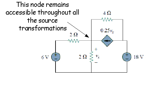

See my post immediately above yours. If you transform away a specific component then you can no longer use that component as a reference. Doesn't matter if a "replacement" component has the same numerical value; it's a different component in a different circuit configuration.
The only thing guaranteed is that the OUTPUT TERMINALS of the transformed circuit block will behave the same as the original.
In your referenced example, Vx is not so much associated with a particular 2Ω resistor but the NODE where all the resistors come together. That node remains despite the source transformations that take place, so it remains a "safe" reference point.
