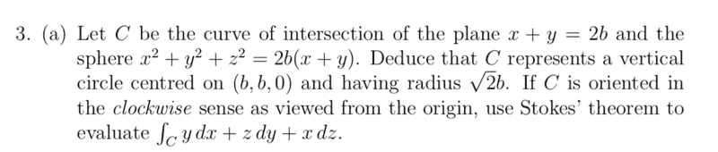

Using Stoke's theorem on an off-centre sphere
In summary: Yes. It doesn't matter what surface is bounded by the curve. No matter which surface you use, its surface integral is equal to the same ##\int_C \vec F\cdot dr##, so they are all equal. So you can evaluate the surface integral over simplest such surface, which is the planar disk.
Morbidly_Green
Stokes theorem
$$\int_C \textbf{F} . \textbf{dr} = \int_S \nabla \times \textbf{F} . \textbf{ds}$$
I have the answer to the problem but mine is missing a factor of$$\sqrt 2 $$ I can't seem to find my error

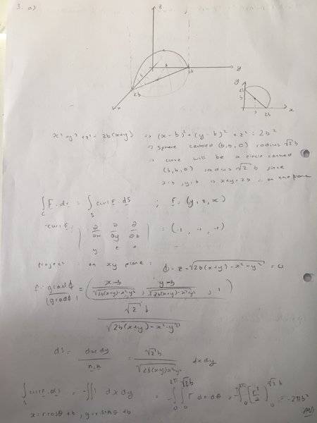

Please write out your attempt instead of attaching an image of it. I cannot read what is in your image.
Apologies for that:
F= (y,z,x)
curl F = (-1,-1,-1)
Projecting the surface on the x-y plane:
Take ##\Phi = z- \sqrt{2b(x+y)-x^2 -y^2} = 0## from the equation of the surface to find the normal n. Then $$\textbf{n} = \dfrac{\nabla\Phi}{|\nabla\Phi|} = \dfrac{\left(\dfrac{x-b}{\sqrt{2b(x+y)-x^2 -y^2}} , \dfrac{y-b}{\sqrt{2b(x+y)-x^2 -y^2}},1\right)}{\dfrac{\sqrt{2}b}{\sqrt{2b(x+y)-x^2 -y^2}}}$$
Now ##ds = \dfrac{dx dy}{\textbf{n}.\textbf{k}} = \dfrac{\sqrt{2}b}{\sqrt{2b(x+y)-x^2 -y^2}} dxdy ##
$$\therefore \int_{S}\nabla \times \textbf{F}.\textbf{ds} = -\int\int dxdy = -\int^{2\pi}_{0}\int^{\sqrt{2}b}_{0} r \ dr d\theta = -2\pi b^2$$
Where for the change to polar coordinates was taken as ##x=rcos\theta +b , y=rsin\theta +b##
The plane ##x + y +0z= 2b## has unit normal ##\hat n = \frac 1 {\sqrt 2}\langle 1,1,0\rangle## in the correct direction. So $$
\oint_C \vec F\cdot dr = \iint_S \langle -1,-1,-1\rangle \cdot \frac 1 {\sqrt 2}\langle 1,1,0\rangle ~dS
=-\frac 2 {\sqrt 2} \cdot \text{Area of circle}$$
You don't need to jump through all those hoops to get the unit normal to a plane nor work the area integral.
Edit, added: What's worse, the plane is vertical and can't be expressed as a function of ##x## and ##y##.
So this is taking the surface to be the circle ? Thats much simpler then, thanks!
