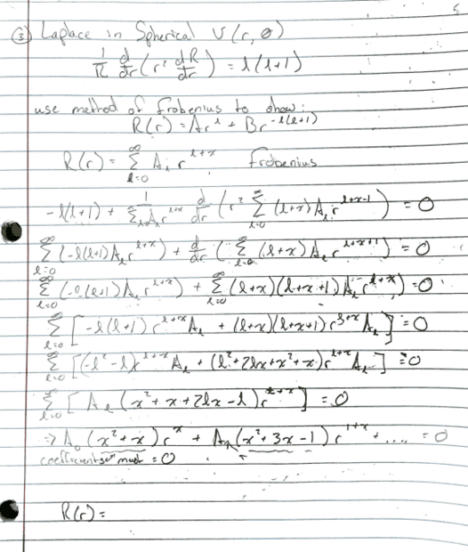

Using the Frobenius method on a 2D Laplace
In summary, the problem is you're using the symbol ##\ell## in two different ways: (1) as part of the constant that appears on the righthand side of the differential equation and (2) as the index of the summation. This can make the equation simpler, but you have to be careful because you can get different results depending on which notation you use.

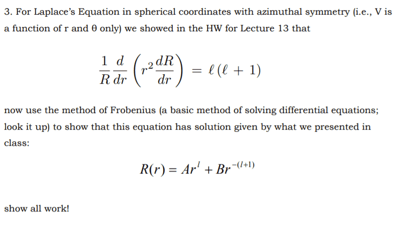

I have some supplemental hmwk that I need to use a method I am not familiar with and I am not sure I have applied it correctly bc if i solve for the missing variable i will not achieve the right answer.
Frobenius method of solving ode

The problem is you're using the symbol ##\ell## in two different ways: (1) as part of the constant that appears on the righthand side of the differential equation and (2) as the index of the summation.

Hint:
$$\frac{\mathrm{d}}{\mathrm{d} r} \left (r^2 \frac{\mathrm{d} R}{\mathrm{d} r} \right)=r \frac{\mathrm{d}^2}{\mathrm{d} r^2} (r R)$$
helps to make the equation simpler.
Then you have to choose another summation variable in your Frobenius ansatz than ##l##, e.g.,
$$R(r)=\sum_{j=0}^{\infty} a_j r^{j+\lambda},$$
and you can assume ##a_0 \neq 0## for uniqueness. Then plug this ansatz into your ODE and determine first ##\lambda## and then the ##a_j## by comparing the coefficients in the generalized power series on both sides of your equation.

Ok so as far as your hint goes, I should be using that whole expression by getting it equal to zero so I have a y" term or that I should only use the right side equal to 0?

Oh yeah i see that now. I got caught up in our notation and other notation when looking up the method. I'll try again using the standard n
Just plug in the ansatz into the equation and compare the coefficients of the series. You'll get an equation for ##\lambda## and then a recursion relation for the ##a_j##.

Update: I got it all correct after just trying again without the confusion of l terms. Did it a couple ways to make sure. Thank you
