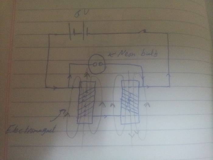

I study physics and I know what the concept self-inductance means, and in one of my study books, a figure like this was used to explain the self inductance in a coil
As shown in the figure, two electromagnets are connected together and the current is passing through them and would produce a magnetic field as shown, I drew it by myself, it wasn't drawn in the original figure. And at first, an induced emf and induced current will be produced, and the induced magnetic field will be in the opposite direction to the original magnetic field. What has attracted my attention is the way the electromagnets connected by, they are connected in a way so that the field between them can be in opposite directions, and I wonder whether it would be the same if we connected them like this:
will this connection affect self-inductance? Or will it make any difference in anything?

It will affect the mutual inductance between the two coils. Self inductance is affected by self-flux only.

Well, to explain self inductance, only one coil is sufficient.
Mutual inductance will depend on the directions of the coils. If the fluxes from the two coils tend cancel each other, mutual flux will be very small and hence, mutual inductance will be smaller than the MI when the fluxes add up.

I reply to my own post beacuase I can't edit it, and in this figure I forgot to draw the base of the two electromagnet existed in the other figure, and I think it has an importance somehow, but I don't know what is it, and the book's author didn't say any thing about it. So, do anyone know why it is here? and how could their connection affect both self and mutual inductance?

Ok, but what about the self-inductance, would their connection by another way affect it?
No.

If the base is made of a ferromagnetic material (like iron), it will reduce the reluctance of the path for the mutual flux. That will change the coupling co-efficient of the coils.
Self inductance will not be affected by the base plate.

OK, but the two fluxes seem to cancel each others in the intermediate area, so the self-flux would be affected by this, wouldn't it?

Mutual inductance **flux** will depend on the directions of the coils. If the fluxes from the two coils tend cancel each other, mutual flux will be very small and hence, mutual **effective** inductance will be smaller than the effective inductance when the fluxes add up.
I should have said "effective inductance" instead of mutual inductance.
Well, effective inductance of the system is a combination of self inductance and mutual inductance. Self inductance has a fixed value determined by its physical parameters and no of turns. Mutual inductance is also fixed, determined by the coupling co-efficient (and geometry). Winding directions decide whether self and mutual inductances add to each other or mutual inductance is subtracted from the self inductance.
Look up "series aiding" and "series opposing" inductance.

I was looking at this not as two coils having mutual inductance (though that is equally valid), but as a single coil wound onto a U-shape core. This shape allows the solenoid's field to pass through a high-permeability material for more of its path to give it a higher self-inductance than for the same number of turns wound on a similar cylindrical but straight core. This being a demonstration of self-inductance, consideration may be on efficiently obtaining a reasonable self-inductance. A donut-shape core would be even better, but it's not a shape that lends itself to DIY experimenters and it can be pain to wind with thousands of turns; further, without an air gap the magnetism can't be gauged with a scrap of steel like it can be for a horse-shoe shape.
(As with a horse-shoe magnet, this U-shape concentrates the field into a narrow air gap should we wish to use it as a strong magnet.)
