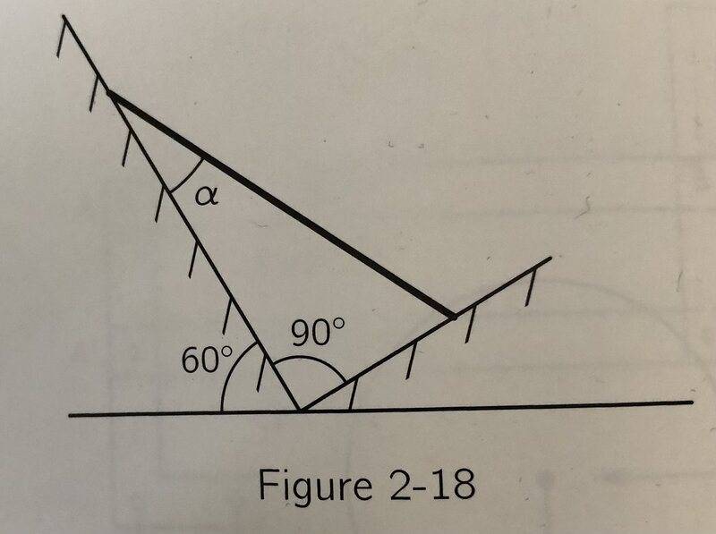

A uniform bar of length L and weight W is supported at its ends by two inclined planes as shown in the attached diagram. From the principle of virtual work, find the angle α at which the bar is in equilibrium. (Neglect friction)
For a system in equilibrium, the work done over a virtual displacement is zero:
ΣFd = 0
I imagined the bar slipping along a virtual displacement, with the top and the bottom slipping by equal amounts. Since the planes are orthogonal, I took the components of these displacements: the lower end is displaced Lsinα in the direction of the right plane and by Lcosα in the direction of the left plane. For the lower end I used the remaining angle in the triangle, 180-90-α = 90-α, giving components -Lsin(90-α)=-Lcosα and -Lcos(90-α)=-Lsinα. I then broke the bar into five points, one at its leftmost tip, one mid way between the centre and the leftmost tip, one at the centre, one mid way between the centre and the rightmost tip, and one at its rightmost tip. I assumed that the distance from the centre would be proportional to the fraction of the displacement of the tips which that point moves, so the center would have no displacement, and the two midpoints would have a displacement of components 1/2 Lcosα, 1/2 L sinα, -1/2Lcosα, and -Lsinα. Since the bar is uniform, both halfs of the bar can be thought of as having the weight acting from the two midpoints so the work done for each of the components would be W/2 L cosα, W/2 L sinα, -W/2 L cosα, and -W/2 Lsinα. Using the principle of virtual work, these should sum to zero:
W/2 L cosα + W/2 L sinα - W/2 L cosα - W/2 L sinα = 0
Dividing the equation by ( cosα W/2 L ) gives:
1 + tanα - 1 - tanα = 0
tan α = tan α
α = arctan(tan α)
α = α
Which is not exactly useful for finding α. What mistake did I make which brought me to this dead-end?

Since any displacement of either end of the rod is orthogonal to the normal contact force, the only force that does work on the rod is the weight ##\mathbf{W}##.
Determine the height ##h(\alpha)## of the centre of mass of the rod as a function of ##\alpha##. Because ##\mathbf{W} = -W \hat{\mathbf{y}}## acts through the centre of mass, the angle at which the weight force does no work when the angle increases by ##d\alpha## can then be deduced by setting ##dh = 0##.

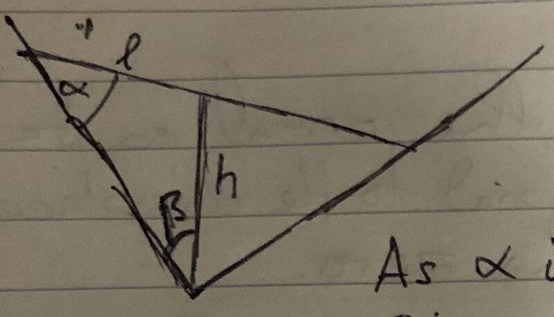

Okay, applying the sine rule:
##\frac{sin\alpha}{h} = \frac{sin\beta}{l}##
##h = \frac{l sin\alpha}{sin\beta}##
Since ##\alpha## < 90 deg, ##sin\alpha## increases with ##\alpha##, and since ##sine\alpha## is proportional to ##h##, ##h## will increase.
The only problem with this is if ##l## or ##\beta## change with ##\alpha## but I honestly can't think of a geometric reason why they should or shouldn't...

You do not need any trig, just basic geometry.
What do you know about the diameter of the circumcircle of a right angled triangle?

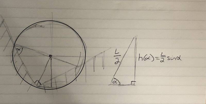

The circle is centred on the centre of the hypotenuse and passes through the lower vertex of the triangle where the planes intersect. So doesn't that meant that the height about this point is simply the radius of the circle, half the length of the bar? I've misunderstood something because the height should be a function of ##\alpha##.
Not the height above the point, the distance from it.

Apologies for the crudely drawn sketch. Is this along the right lines?
##h(\alpha) = \frac{L}{2} sin(\alpha)##
The left hand drawing is ok, but that angle in the right hand drawing is not alpha.
Try drawing some special cases, like alpha=0, alpha=pi/2, or the centre of the rod directly above the intersection.

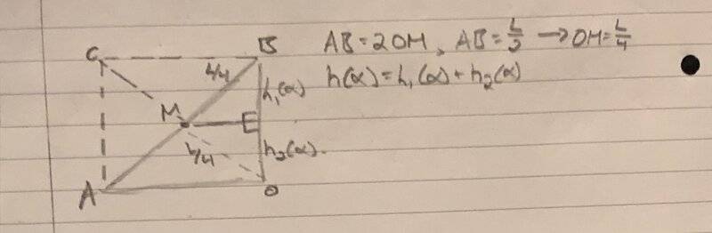

Consider a ladder, AB, midpoint M, leaning against a wall. The wall meets the floor at O.
Complete the rectangle AOBC. AB and OC are diagonals of the rectangle crossing at M.
What is the relationship between the lengths AB and OM?
If the ladder slips, what is the path of M?
AB will be twice OM, and M will move up and to the right
If AB is the radius of the circumcircle of the triangle, ##\frac{L}{2}## then ##OM=\frac{L}{4}##. This prompted me to split the height into two sections being sides of two triangles, one with hypotenuse MB and another OM and I've drawn a diagram to show this. This still leaves the task of finding the angles of the triangles to calculate the lengths of the sections, which I attempted to do (in a very long winded way - I think I had the completely wrong approach) but it came out as the wrong answer anyway
Not if the ladder is slipping down.
It is the diameter.
But the important point is that OM is constant. So what is the path of M?
