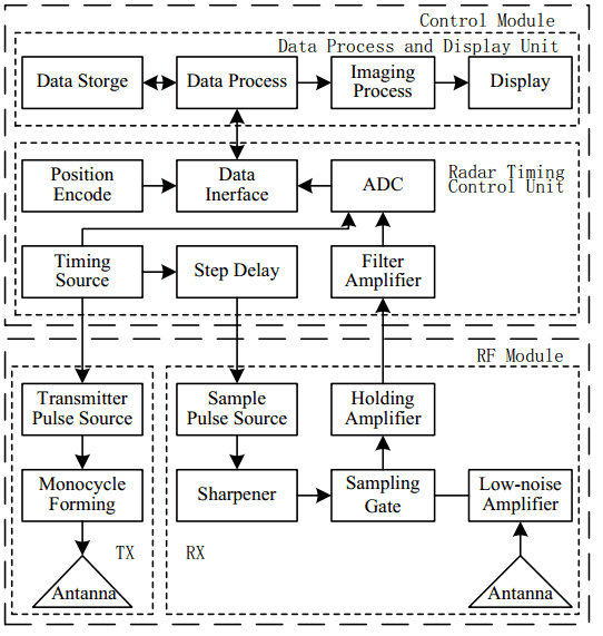

let me show you a block diagram. Its of a UWB transceiver. But I think it would be too expensive to make and time duration is just 1 year. If there is a cheaper alternative, I would love to hear it. It needs not be state-of-the-art. Schematics will be appreciated. :)
Exactly. UWB is also severely power restricted. There are many GPS units on the market. Have you tried to understand how they work? Most of them just transmit a pulse and wait for the echos. Some are carried or rolled along the ground to create a two dimensional image. The depth of penetration is inversely proportional to the frequency but the resolution is directly to it. Here are a few issues to consider:
The shorter your transmitted pulse, the better your depth resolution will be. How short will your pulse be and how will you generate it?
If your pulse is only a few wavelengths long, how will you prevent ringing on the trailing edge of the pulse?
Will you use the same antenna for transmit and receive? If so, how will you switch from transmit to receive in the appropriate amount of time?
If you will be using a sample and hold to capture the echos, how will you know you are capturing the total power of the echo and not just the instantaneous power of the signal's sinewave?
