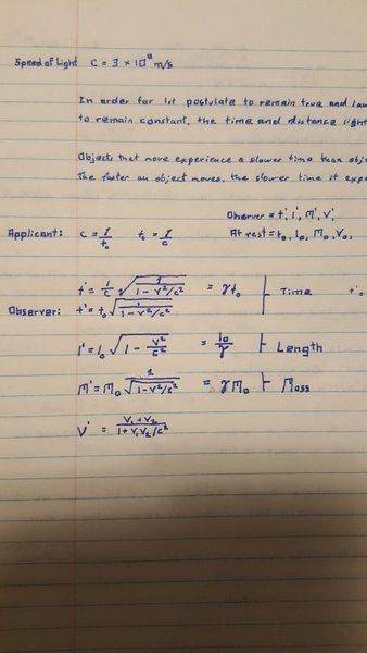

Velocity Equations for Relativistic Mass,length contraction and time dilation.
I was able to figure out one. This is not for homework. I want to learn these equations for future reference.
Length Contraction : v = c √{1-(l'/lo)^2}
Time Dilation: ?
Mass: ?

l'/lo = √{1-v^2/c^2}
(l'/lo)^2 = 1-v^2/c^2
1-(l'/lo)^2 = v^2/c^2
√{1-(l'/lo)^2} = v/c
c√{1-(l'/lo)^2} = v

I just copied the equations from wiki to this platform but i now have come to realize they are the same.
This is pretty self explanatory. i was given equations from my lessons that were essentially the same but all look different so i got confused. I didnt even look at the wiki equations closely until now :sorry:o_O:frown:
Well done.
The form of the equations is ##x = \frac{y}{\sqrt{1-z^2}}## and you want to solve for ##z##.
It does not matter what the actual letters are.
It is more important to understand how to use the equations - that is the hard part to get your head around.
