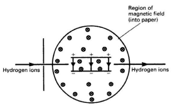

Hydrogen ions moving at various speeds are directed at a region of combined electric and magnetic fields as shown in the diagram below. The electric field is between two parallel plates 10 mm apart with a potential difference V across them, while the magnetic field of flux density 0.1 T is at right angles to the electric field.
(a) Calculate the value of V required so that ions of speed 100 m s-1 pass through the region of the two fields without being deviated.
(b) What is the kinetic energy per ion as they leave the combined fields?
(1 u = 1.67 * 10-27 kg.)
Answers: (a) 0.1 V, (b) 8.4 * 10-24 J.

You're plugging in numbers way too soon. Use symbols to start with.
What condition must hold if the ions are not going to be deflected? Can you write an expression for that?
Also, you may want to check that the given answer for part (b) is not a typo. Something on the order of 10-4 Joules for a single hydrogen ion would be mighty impressive indeed.

Are there two magnetic fields? What is the purpose of the parallel plates?

What do you think is the purpose of the plates? What forces are acting on the ion when it gets in between the plates?

Hint: The mass of the particle is irrelevant until you need to talk about kinetic energy. Only magnetic and electric forces are of interest right now.

Plates do not create a magnetic field. What kind of field do they produce when they are supplied with a potential difference?

Magnetic field will tend to deviate the ion. But if the ion is not supposed to deviate along its way, what will stop it from deviating?

There are only two forces operating: The magnetic field and the electric field. You should be able to write expressions for both as they act on the moving particle.

I'm not sure why you seem to being denying the existence of the electric field between the plates :oldconfused: You seem to be going out of your way to avoid mentioning it. Perhaps you haven't been introduced to electric fields between parallel plates?
The purpose of the plates with a potential difference V is to establish an electric field between them. Now. What is the force on a charge in a uniform electric field E?

The ions experience a force due to the electric field between the parallel plates...do you know how to calculate this?
They also experience a force due to the magnetic field...do you know how to calculate this

F = e V in electric and F = B e v in magnetic fields?
e V = B e v
V = B v = 0.1 * 100 = 10 V, not 0.1 V.

The second one is correct but the first is not. You should familiarize yourself with the difference between potential difference V in Volts (which is a name given to the unit combination Joules/Coulomb) and an electric field E in Volts/m (which is also the same as Newtons per Coulomb). e V (charge in Coulombs times potential difference in Volts) would yield a result in Joules (energy) not a force.
The potential difference between the plates (V) establishes an electric field (E) in the gap between the plates. You should do a bit of research on this so you know how to determine one from the other. Perhaps look up "electric field parallel plates" with a search engine.

First term is incorrect. And the charge should be q instead of e since the ion is not an electron.
