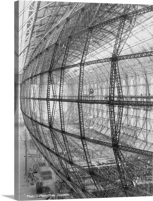

A large, cylindrical chamber is a row of truss bridges, from a structural standpoint. I don't think the hoop stress idea for pressure vessels really applies. The structure needed to hold a vacuum is not fundamentally different (just more substantial) than the structure needed so it doesn't collapse under its own weight:

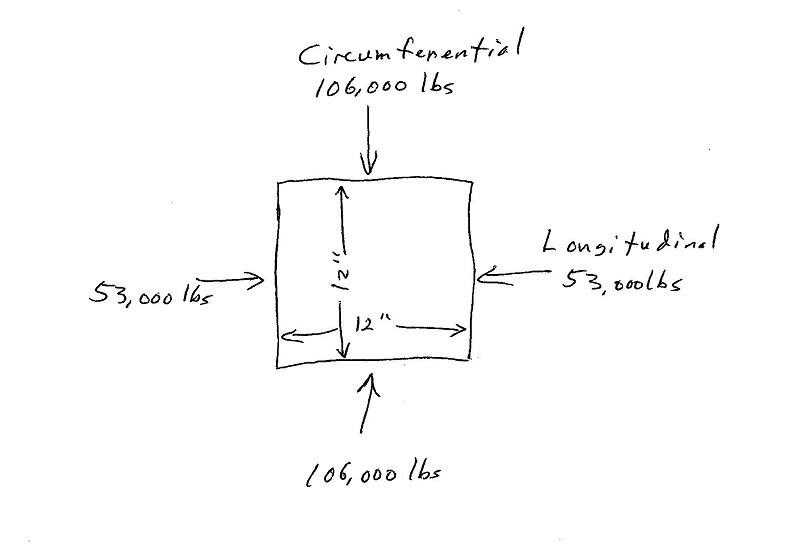

The hoop stress idea for pressure vessels doesn't really apply.
It works quite well for submarines.

I think the rules change when the structure gets longer and thinner and the pressure lower. I think that that the flatter the arch, the closer it is to a bridge than a small pressure/vacuum vessel. And I think the difference is the buckling failure you set aside in your earlier post. Avoiding buckling is what a bridge does.
For a pressure vessel, hoop stress is everything. They don't buckle because the pressure opposes the buckle and makes them stable. That's why a mylar balloon can hold pressure even though un-inflated, it is just a pile of mylar on the ground. But if you inflate it, you can poke at it with your finger and it won't buckle/collapse. But for a vacuum, buckling is a key failure mode.
I'm having trouble finding specific reference for what I'm describing, but mathematically: because the hoop stress equation is linear and moment of inertia of a beam quadratic, reducing the thickness as you reduce the pressure should increase the risk of buckling.

A double walled envelope with internal gas pressure, sufficient to keep the ends apart, weighs too much. So there must be a rigid two-layer-truss structure to keep the ends apart and prevent an implosion. A slack envelope would rest on the outside of the truss, with inward dimples wherever there are holes in the truss. That would reduce envelope surface tension being added to the truss stress.
A fixed volume balloon/airship would need to start from the ground with about 0.75 bar internal air, that would be pumped down towards zero as altitude increases, maintaining the 0.25 bar difference as it climbs. That procedure reduces the maximum envelope differential pressure to 0.25 bar.
So what is the real challenge?
It is the design of the light-weight truss structure that supports the envelope.

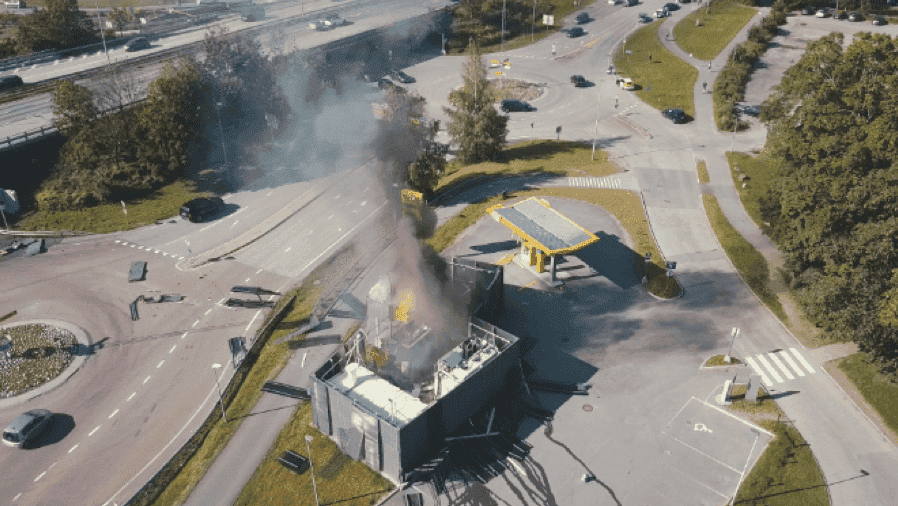

Well close to where i live there was a explosion at a hydrogen filling station last year.
The investigation concluded that the cause was a leak because of two bolts on a hydrogen bottle that was not tightened enough. So yes small slow leaks of hydrogen can definitely cause explosions. At least in enclosed spaces. And in open places it can cause fires really easy. And even if a human is not harmed the balloon material and the satellite electronics will most likely be damaged.
And even though hydrogen does not accumulate unless it is in an enclosed space like propane does, hydrogen has a really large flammability range as i said. And it leaks a lot easier than propane. In fact it often leaks by design because of boil off that is vented to the air when stored in liquid form, or it just leaks right trough materials (like the balloon skin) in gas form.
Then they should stop supplying hydrogen to all transport, because it is safer to use it in high altitude balloons.
Can you provide a link to a description of that incident? I'm seeing very little damage and evidence that the building was probably designed to survive a minor explosion (with blow-off panels).
Another attribute of hydrogen vs propane is it is very light, so it has something like 1/10 the energy density for a confined space explosion (or 1/3 that of natural gas). So smaller confined space explosions pose less risk.
Let's put that another way; natural gas is much more dangerous than hydrogen for a confined space explosion, yet it is extremely commonly used in confined spaces (buildings). Explosions do happen, but they are rare enough it is considered worth the risk.

You are imagining it. There is no problem with high altitude hydrogen balloons.
Am i imagining the exploded hydrogen filling station in the picture above?
Or am i imagining that a hydrogen balloon filling station will be essentially the same as a hydrogen car filling station except the customer filling parts? Look at the picture. The part that exploded is the elektrolyser and hydrogen storage building.
russ_watters said:
Googling around, I found THIS document on hydrogen fuel for transportation, which includes a case study. The media inaccurately described it as an explosion, but the operator sustained only minor uv radiation burns and the truck was still drivable. The difference definitely mattered there.
I have just showed you a hydrogen station that exploded just a year ago throwing debris everywhere. And this is one of only a few in operation in my country. If there was more of them the explosions wold have happened more often.
And burning off the hydrogen in the air before launch like NASA does with it's rockets will not work either. The rockets aluminium skin can handle the heat for a couple of seconds but i am pretty sure the ultra thin skin of a high altitude balloon can not.
