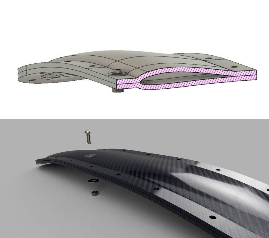

I'm trying to make a near 100% solid carbon fiber wing. I'm vacuum bagging the top half of the wing and the bottom half of the wing separate.
After making sure there is a thin 2mm gap b/w the center of both halves the goal is to put a very strong, thick epoxy between them and clamp the mold together.
I'm wondering if I should use the vacuum bag for this process or use a series of bolts and washers as seen in the attached picture?
![zkkA9k7.jpg zkkA9k7.jpg](https://www.physicsforums.com/data/attachments/227/227312-d1984d0bc361e4999622d2659b154b72.jpg)
<Moderator's note: post edited to include the image. Please do not use external image servers.>
Questions:
1) The surface area of the top side of the mold is 80 sq in and the bottom is 75 sq in. If I draw a vacuum strong enough for 14psi is my total force 155 sq in x 14psi = 2170 lbs?
2) If I use 20 bolts with the a surface area of the washers touching the flange of .38 square inches each and each washer can apply a force to the flange of 300 psi is my
total force on the part theoretically 20 bolts x .38 sq in x 300psi = 2280 lbs?
*The above questions are assuming a near perfectly rigid mold. I'm just trying to see if my math is right.3) Will only the excess resin seep out of the seems of the parts if I vacuum bag the halves together or will the vacuum cause more resin to escape the mold? I think in theory the vacuum shouldn't cause excess to seep out.Thanks.
