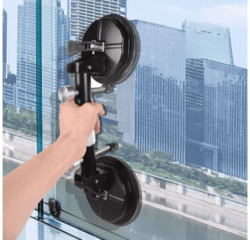

I am trying to figure out a device that uses fan vacuum and suction seal, and a little bit of ground effect with a fan to adhere to objects, I'm by no means a learned man, and i was wondering at a base principal, if you had a flat plate with a sealed vacuum against a surface, ( i know there are things available, on market but i want to get my head around the core principle )
Would increasing the inner surface area with a dimpled, pins or other geometry increase the surface area that is seen to the pressure. thereby lowering it?
likewise would increasing the outer surface area shown to atmosphere increase the force instead?

Is there a reason you want to use a fan to create the lower pressure? Can you say more about the application? What makes it so that regular mechanical suction cups won't work for your application?

The surface can be contaminated and irregular and have things like weld beads and bolts, and the seal basically needs to be able to move and conform,
