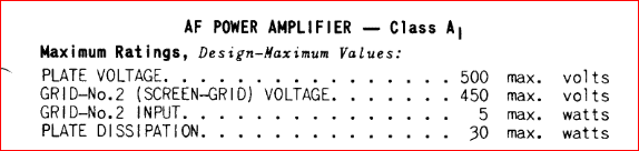

How do I go about finding the true dissipation in watts for a 6l6GC running in my amp?
I have seen data sheets that say everything from 25 watts to 40 watts.
So...assuming a plate voltage of 450V just as an example it goes like this. 25 / 450 =0.05555555555555556 X .7 = 0.0388888888888889 or APX 39 ma plate current at 70% of max. For 40 watts at 450V the plate current at 70% of max would be 62 ma
50% could be considered cool 60% perhaps normal 70% Hot and 80% really pushing the limit with for sure shorten tube life.
For my own amp I don't care if I have to replace tubes every three months if I get the sound I want but I assume not many people would be willing to spend that money for tone.
What's wrong with measured (plate volts X plate amps ) ?
So I run the amp into a say 250 watt 8 ohm resistor dummy load and turn it all the way up and measure the plate current?? I also assume some amount of drop in plate voltage at full volume...well I guess...never measured the plate voltage at full volume before.
I guess my real question is the data sheet stated dissipation in watts is only correct if everything in the tube is up to specs...correct?
i think the datasheet says 30 watts is maximum , presumably continuous.
Have you noticed the plates glowing red? If not you're probably ok.
