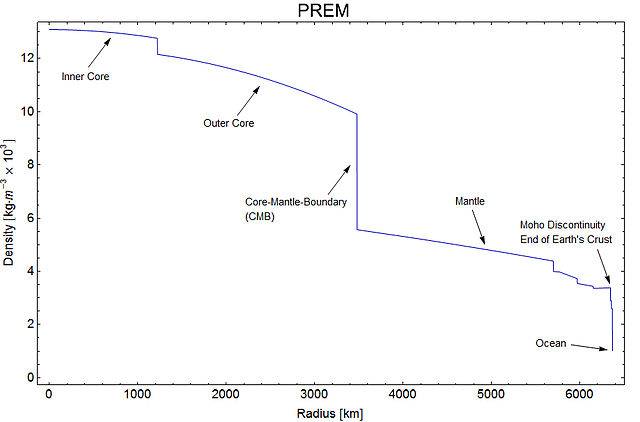

carrz said:Speaking of which, what is it that makes inner core more dense than the outer layers, is it its own attraction towards the center, or is it pressure from the layers above, or maybe both?

Below is a plot of density as a function of distance from the center of the Earth, based on the Preliminary Reference Earth Model:carrz said:Speaking of which, what is it that makes inner core more dense than the outer layers, is it its own attraction towards the center, or is it pressure from the layers above, or maybe both?
D H said:Note that density generally decreases gradually with increasing distance from the center but is punctuated by some marked step changes. The gradual decreases in density result from decreasing pressure. The step changes represent physical differences in the constituent matter at those step change boundaries. The largest step change is at the core-mantle boundary. The Earth's core is primarily iron and nickel, which are rather dense even at the surface, and are significantly more dense at the immense pressures inside the Earth. The mantle and everything above is "rock".
That different materials differentiate by density is critical to understanding the makeup of a planet. All of the terrestrial planets have a differentiated core, and the gas giants most likely have one as well.carrz said:That's really interesting graph, but different materials make the question less clear.

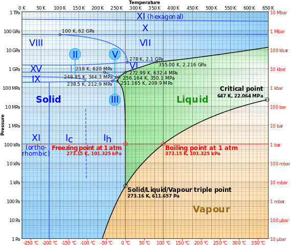

What acceleration? A planet or star is more or less in a state of hydrostatic equilibrium, where the gravitational force and the gradient in pressure are in balance. There is no acceleration. Understanding hydrostatic equilibrium is easiest for a star or the atmosphere of a planet, where there are no phase changes. With regard to your hypothetical planet that is pure water (which can't happen!), hydrostatic equilibrium explains why pressure and density increase with increasing depth.Suppose a whole planet is made of water. We now look at three molecules of water half-way to the center, they are right on top of each other. How much the distance between the bottom and the middle molecule depends on acceleration of the middle molecule itself, and how much it depends on acceleration of the molecule above it?
D H said:What acceleration?
What hydrostatic equilibrium by itself cannot explain is why even your pure water planet would have step changes in density. At some depth, that liquid water will become solid, and it won't be the kind of ice that floats. It will instead be ice VII, ice X, or ice XI. In fact, you will see multiple step changes in pressure as liquid water transitions to ice VII, then ice X, and then ice XI.
