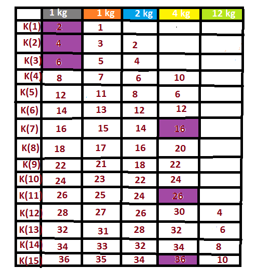

$$K(2)=\max \left\{\begin{matrix}
K(2-w_{\text{gray}})+v_{\text{gray}}=4\\
K(2-w_{\text{orange}})+v_{\text{orange}}=3\\
K(2-w_{\text{blue}})+v_{\text{blue}}=2
\end{matrix}\right. \left.\begin{matrix}
\end{matrix}\right\}=4$$

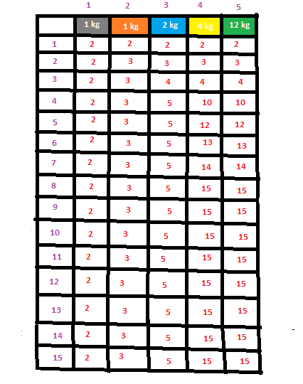

I like Serena said:
Wait! Maybe we could create a table? (Wondering)
That's what I have tried (Blush)
Is it right or have I done something wrong?(Thinking)
Good! (Happy)
It looks good to me!

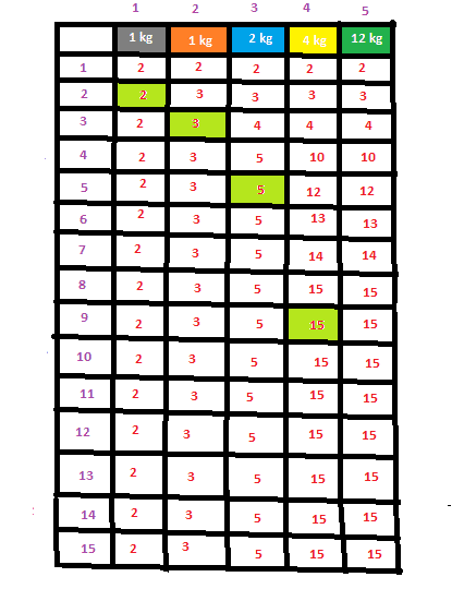

(Happy) From this table,can we just find the value of the optimal combination of objects with total weight $W$,or can we also find which objects we have to take to get the optimal combination? (Thinking)

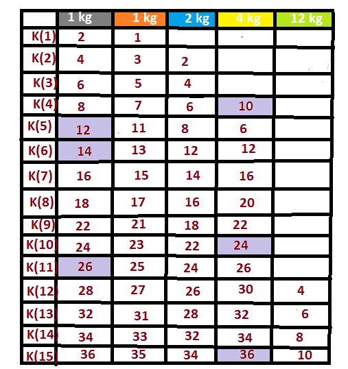

Yes... yes we can. (Poolparty)
We can do so by working backwards recursively.
The total value at $w=15$ is $K(15)=36$.
Since this is in the yellow column, the yellow object was added last.
So for starters, we have a yellow object.
The yellow object has weight $4$, so we go back to the optimal combination at $w=11$. We can choose either the gray column or the yellow column, since both contain the number $26$.
If we pick the yellow column, we extract again a yellow object with weight $4$.
And so on... (Nerd)
And so on... (Nerd)
I understand.. So,one possible combination is this one,right? (Malthe)

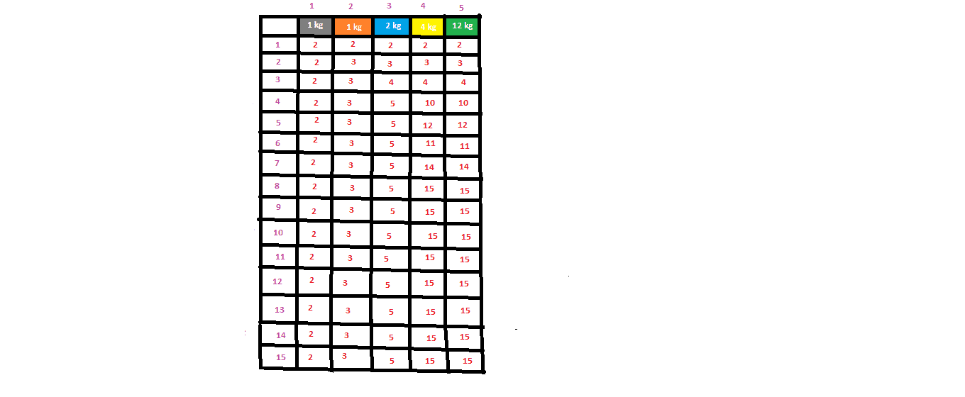

(Thinking) Could you also give me an example,so that I can see if I have understood it? (Blush)
Yes.
It shows how you want as many yellow objects as possible, since it has the highest specific value of 2.5 \$/kg.
And continue with the next best specific value of 2.0 \$/kg, the gray objects, which uses up all available space. (Nerd)
Perhaps you can explain what you have understood? (Wondering)

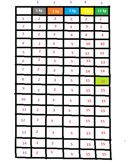

So,since we want as many yellow objects as possible,is this the best combination? (Thinking)
We want to determine if we have to pick the $j^{th}$ object,or not..If it is valuabe and we decide to take it,then we add at the value of the optimal combination of the first $j-1$ objects, the value of the $j^{th}$ object,if we don't take it,we have by now the value of the optimal combination of the first $j-1$ objects. (Thinking) (Blush)

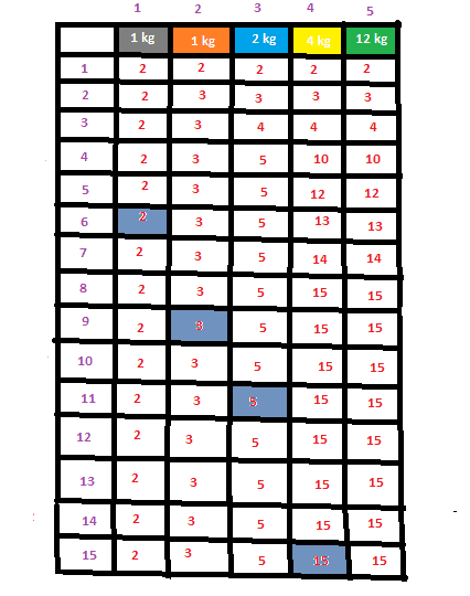

I like Serena said:
How about $K(2,j)$, $K(3,j)$, and $K(4,j)$? (Sweating)
I tried to create again a table:
Is it right? (Thinking)
Also,do I have to find $K(i,j), \forall i \in \{ 1, \dots, 15\}$ ? (Thinking) Because,I noticed that,after having found $15$,the results didn't change.. (Thinking) (Blush)
I only see a mistake in K(6,4) and K(6,5), which should both be 13.
Otherwise it looks good! (Smile)
You still have to find them, since you ultimately want to know $K(15,5)$.
But yeah, effectively there's a lot of the knapsack's capacity we can't use. (Doh)

evinda said:
How do we see that there's a lot of the knapsack's capacity we can't use? (Thinking)
We can carry a total weight of 15 kg, but the optimum we found is only 8 kg.
Ah well, I guess we'll travel light then. (Mmm)

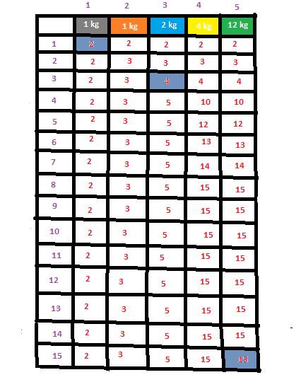

How can we see from this table which is the best combination? (Thinking)
Can you follow the trail backward from the end? (Wondering)
(Bigsmile)
So,is this one best combination?
And..this is an other one,right? (Thinking)

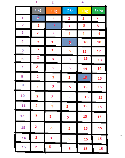

The optimal value is $K(15,5)=15$.
The first time we found this optimal value was at $K(8,4)=15$.
How did we find it?
Where were we coming from?
Which object was added? (Wondering)
How did we find it?
$$K(8,4)=\max \{ K(8-4,3)+10,K(8,3) \}=\max \{ K(4,3)+10,K(8,3)\}\\ =\max \{ 5+10,5 \}=\max \{ 15,5\}=15$$
So,we added the yellow box,in order to get $15$,right? (Smile)
Yep. (Happy)
So we came from K(4,3) and added the yellow box.
And before that?
I like Serena said:
Yep. (Happy)
And before that?
$$K(4,3)=\max \{ K(4-2,2)+2,K(4,2)\}=\max \{ K(2,2)+2,K(4,2) \}=\max \{5,3 \}=5$$
$$K(2,2)=\max \{ K(2-1,1)+1,K(2,1) \}=\max \{ K(1,1)+1,K(2,1) \}=\max \{ 3,2\}=3$$
$$K(1,1)=\max \{ K(0,0)+2,K(1,0)\}=\{ 2,0 \}=2$$
So,is this one best combination? (Thinking)
But..what if we start with the green box? (Thinking)
It is:
$$K(8,5)=\max \{ K(3,4)+4,K(8,4)\}=\max \{ 8,15\}=15$$
Does this mean,than we cannot take the green box,to have a best combination? (Thinking) Or am I wrong? (Thinking)
Yep!
It is:
Hold on. The green box weighs 12 kg. So you'd come from $K(-4,4)$ instead of $K(3,4)$. (Wasntme)
So no, we don't want the green box.
It's too heavy for too little value. (Speechless)
Oh,yes! You are right! (Blush)
A ok! I tried to start with $T(9,4)$ and got the same combination. (Wait)
$$K(9,4)=\max \{ K(5,3)+10,K(9,3) \}=\max \{5+10,5\}=\max \{15,5 \}=15$$
$$K(5,3)=\max \{ K(3,2)+2,K(5,2)\}=\max \{ 5,3\}=5$$
$$K(3,2)=\max \{ K(2,1)+1,K(3,1)\}=\max \{ 3,2\}=3$$
$$K(2,1)=\max \{ K(1,0)+2,K(2,0)\}=\max \{ 2,0\}=2$$
So..this is the only best combination,right? (Thinking) Since,there is only one of each object,or not? (Blush)
