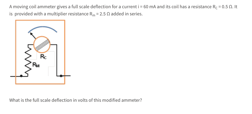

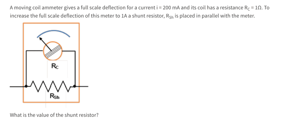

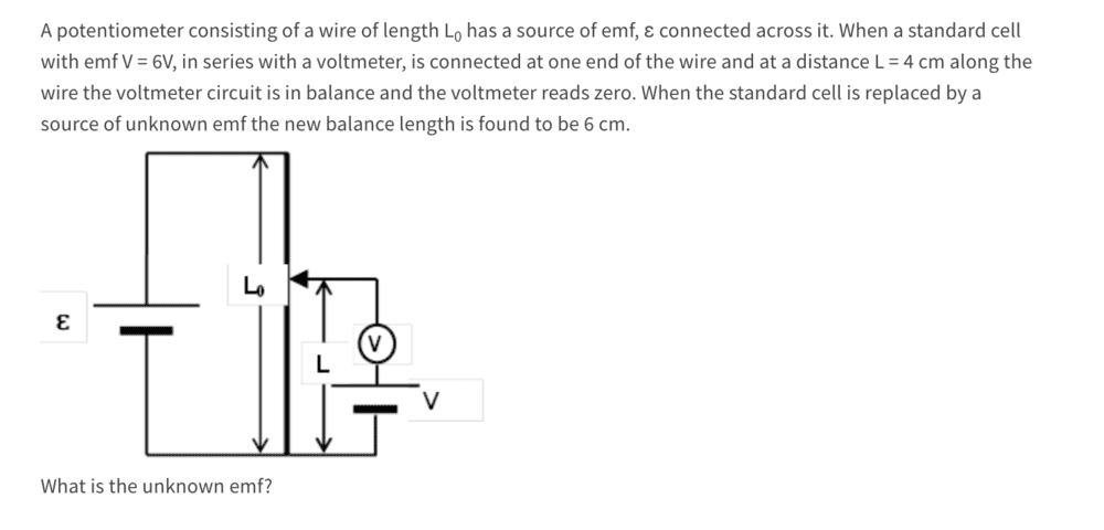

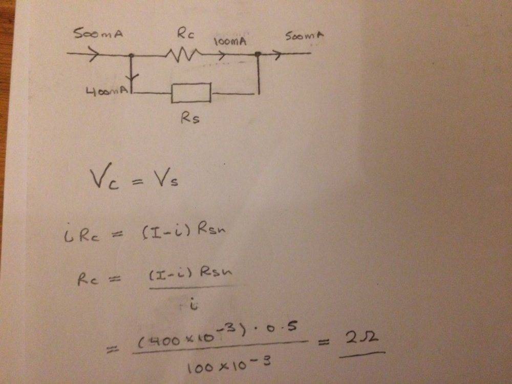

Here are a couple of questions that I have been trying to answer and had a go at it.
Not sure if I answered some incorrectly so was hoping to get some guidance

Your work on the first three looks fine.
In the last one, isn't Ic the current through the ammeter? That is not 1A.
Seems to me that the set up is the same as in the third problem, so you can use the same method.

Thanks I have realized that voltage across the shunt and coil would be the same as they are connected in parallel. And that current would also split too at the junction.
I did this and get a resistance of 0.25 ohms for the shunt

Yes, but you can get there more quickly. You know that 1A-200mA=800mA is going through the shunt. That's 4 times the current for the same voltage, so a quarter of the resistance.
Likes Bolter
Yes this is much more efficient way of doing now that I can see :)
