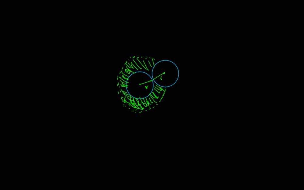

  • Doesn't volume of ideal gas include volume of the molecules?
  • What I was taught in school is that, when two molecules collide, no other molecule can come around it (inside the green part in the figure) and that volume is excluded volume? Is it correct? If yes, why?

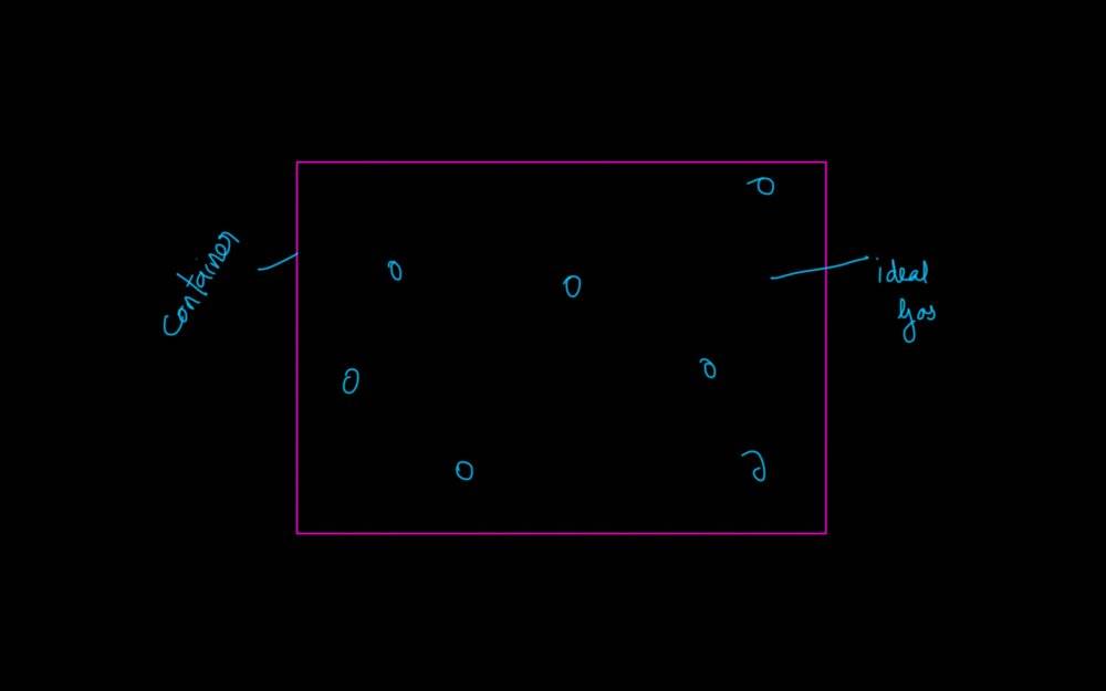

When we talk about volume of gases, is it the volume of the container, or the volume of the molecules or is it both?
Let Ideal Gas A be kept in a container of Volume V. Is ##V_{ideal} = V_{container}##?
In general by "volume of a gas" we mean volume it occupies - so the volume of the container. That in turn is sum of volume of the gas molecules (let's not get into details, as they are a bit fuzzy) and the space between them.

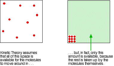

The kinetic theory assumes that, for an ideal gas, the volume taken up by the molecules themselves is entirely negligible compared with the volume of the container. For a real gas, that assumption isn't true. The molecules themselves do take up a proportion of the space in the container. The space in the container available for things to move around in is less than the measured volume of the container.
Source
After reading the above, my interpretation of volume of gas is that the space for the molecules to move around. When we consider the volume of molecules, then the space for it to move around reduces.
But according to my interpretation the volume of real gas should be lower than the volume of ideal gas which is not true.
But when we talk about volume of ideal gas, we are considering the volume of the container which is the sum of volume of molecules and the space in between them. Then what do we take into account when we say volume of molecule is negligible as compared to volume of container?
What is the reason for this? (find the figure attached above)
Yes

Can you answer the below question?
In an ideal gas, the volume of the molecules is zero, so of course zero is negligible as compared to the volume of the container. Saying that something is negligibly small is another way of saying that we will assume that it is zero.
You do realize that ideal gasses do not exist, right?
Likes Kaushik
phyzguy said:
Yes
So you said that ## V_{container} = V_{ideal}## .
Then what is volume of real gas?
Is it ## V_{real} = V_{container}+V_{molecules}##?
If that is true, my question is 'Doesn't Volume of the container already include volume of the molecules as they are inside the container?'
I'm completely lost as to what your question is. I think this is an obvious concept and you are just trolling. I have done my best to try and explain, but I am dropping out of this thread now.
Likes Kaushik
Apparently confusion stems from the fact "volume of the gas" is ambiguous and can mean both "volume it occupies" and "volume of the molecules themselves". As long as you don't start to pay attention to what you really mean things won't get better.

We haven't addressed part two of your post #1 yet:
Could it be that this is what you remember, not what you were taught ?
I find your picture back e.g. here (halfway the page)
The green zone in your picture is inaccessible for the center of any particle, whether or not a collision takes place. (the molecules are considered to behave as hard spheres)
Here they calculate the mean free path for Ar molecules: 130 diameters. So you can figure collisions of three particles are extremely rare.
Why?

Kaushik said:
Why?
Let me spell it out: If you place a coin with radius R on the table -- call the location of the center point the origin -- then with the center point of another same coin you can not get closer than 2R to the origin. Because that's when the edges of the coins hit each other.
That's all.
Try it out
Likes Kaushik
That's all.
Try it out
Thanks!
The excluded volume of 2R radius around the centre of one particle is more of a hard-sphere notion. In the true picture of the collision that excluded volume radius can vary, two particles can approach closer than 2R.
