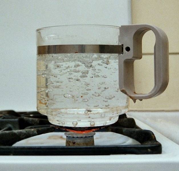

In order for the water to boil (i.e., for bubbles to form below the surface)
Why boiling is indicated by bubbles formed below the surface?
I have been thinking that boiling should be indicated by vapors quite above the vessel/in atmosphere,because boiling occurs when vapor pressure becomes equal to atmospheric pressure and vapor pushes atmospheric air to escape from boundaries of vessel into the atmosphere.
No. Your description is not what boiling is all about. Do you not see the bubbles of water vapor within the water in the container in your picture. That's what I'm talking about. As I said in my previous response, in order for those bubbles to form under the liquid, the vapor pressure of the water has to equal the pressure of the atmosphere above the boiling liquid, so the volume of the mixture of liquid and bubbles can expand.
Chet
And what about surface bubbles?Don't they indicate boiling?

When the bubbles reach the surface, they release their water vapor into the air. After that, diffusion takes over.

Bubbles form beneath the surface because the heat is being applied to the bottom of the vessel, making the water at the bottom the hottest.
I'm not sure what you mean by the first part, but the second part is basically correct, though not exactly relevant since boiling first occurs below the surface where there is no air.
