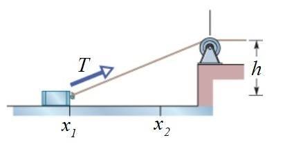

The figure shows a cord attached to a 2 kg cart that starts from rest and can slide along a frictionless horizontal rail. The right end of the cord is pulled over a frictionless pulley at height h = 2.0 m above the point of attachment of the cord to the mass, so the cart slides from x1 = 4.0 m to x2 = 1.0 m where x is measured positively to the left from a line that passes vertically through the center of the pulley. During the move, the tension T, in the cord is a constant 49 N. What is the speed of the cart (in m/s to two decimal places) when it reaches x2 ?

I understand that the force on the object varies due to the changing angle of the applied force, and that the relevant component of the force is equal to the cosine of the angle. I found this to be Fcos(arctan(2/x2-x1-D)) where D is the distance the mass has traveled at any given point in time. I don't have any idea where to go from here because it seems that I must keep substituting the same equation into itself if I use a = F/m. Thanks for any help.

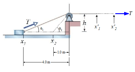

Here it is
(Mentor's note: edited post to expand thumbnail image)
You can either integrate the horizontal component of the force over the distance that the cart moves, or perhaps do something clever...
Notice that the horizontal part of the rope after the pulley also has a force pulling it to the right. That force is constant and always horizontal. Does that suggest anything to you?

Your integral outline is okay. The angle varies of course, and you should be able to use the basic trig function definitions (ratios side lengths of the triangle) to write an expression for ##cos( \theta )## in terms of x.
As to what I was hinting at, note that by conservation of energy, the energy that's put into the cart must be the same as the work that's done pulling on the rope. The horizontal part of the rope moves a certain distance, say from x'1 to x'2, while the cart moves from x1 to x2. But no angles are involved here: it's a straight line motion, and the force is constant... can you determine how far the rope moves?

Any point in the rope moves a distance equal to the difference in the hypotenuses of triangles x1 and x2. Therefore
## \sqrt\frac {2F(A-B)} {m} = v ##
Where A and B are the hypotenuses of the aforementioned triangles.
Looks good :smile:
