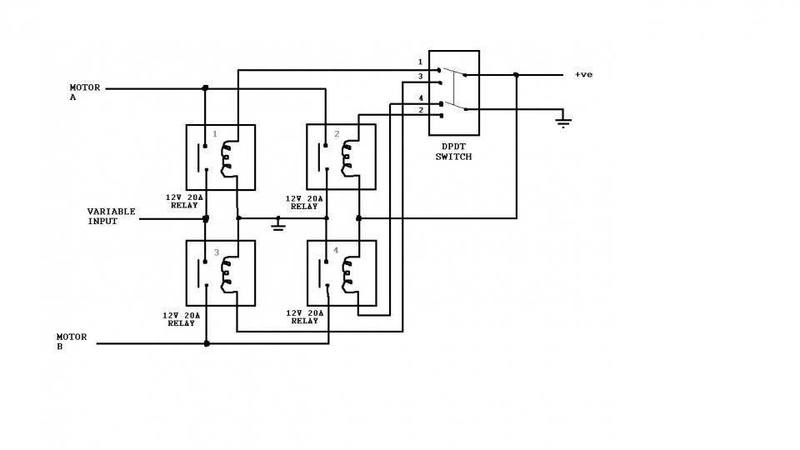

so you can see what I have done with the relays here is a circuit diagram I did crudely with Paint.
This part at least works perfectly, just the pot wasn't useful to vary the supply.

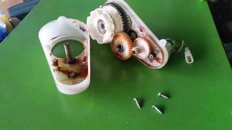

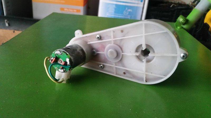

Can you supply a picture or sketch of the assembly of one wheel and motor ? Need to see what it looks like to suggest a simple and rugged feedback device .
Likes dubya_80
I'm on my way to work atm. The motor and reduction boxes I'm using are straight off a few kids electric cars . I can upload a picture this arvo, including an unassembled view, as i have spares
This is a buggy for the kids to burn around in, right? So expect half the time 2 wheels will be barely contacting the ground...
Likes dubya_80
Quite possibly! The wheels that aren't on the ground will pinch all the power? Or is there other issues I'm not considering?
The wheel off the ground will tend to speed up considerably unless there is provision in the control system to detect the overspeed and reduce power to that wheels motor .
Likes dubya_80
These are pics of the sort of motors and reduction gears I'm using

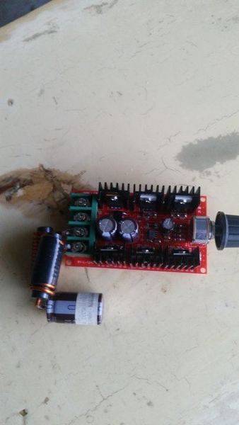

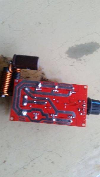

I have removed the inductors and capacitors from the ones I installed, and now I am realising what they do! What sort of things should I consider using caps and inductors?
My PWM module arrived today so i went about getting it ready to install and it's got a common +ve! So I'm off to rewire the relays to separate the circuits!
Could you post a copy of any technical data that came with the module ?
it didn't come with any!
all I have to go by is what's on the sellers Ebay page.
none of the transistors or the IC have any markings either.
I'm mounting it in a fan cooled box before I test it out.
I am uneasy at your plan to use relays to reverse the load. Without spike suppression, opening the motor under load may produce switching transients which could kill the PWM controller.
Some controllers apparently have an inbuilt reversing switch, if I read this advert correctly. http://www.ebay.com.au/itm/Hot-Reversible-3A-Pulse-Width-PWM-DC-Motor-Speed-Regulator-Controller-Switch-New-/331614500577
Likes dubya_80
I guess I'll just test this unit in one direction and if it tests out ok just order a second one for reverse. .
Did you ask the seller for a link to a data sheet? It's hard to believe he would be buying these from a supplier who has no additional information on them.
Well i just went by the info on the ad itself. I added a cooling fan to be safe and crossed my fingers! I got lucky with the 4 motors seeming to cancel each others electrical noise! I put the car on crates and when I put load on two wheels the other two just slowed to match and there was barely any voltage spike at all!
