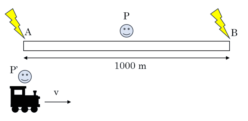

Imagine we have an observer (P) standing on the platform, midway along the platform. Say the platform is 1 km long (for the sake of brevity). They observe two lightning strikes either end of the platform (A and B) occur simultaneously in their reference frame. However, we have another observer on the train (P'), travelling at some velocity v, passing the platform on one end (A) exactly as the lightning strikes, instead of being midway along the platform as in the original thought experiment.
Now we can imagine that at low speeds (v << c), P' would observe A occur before B, because the light from B would have to take some time to travel to reach the train from the other side of the platform, which would have hardly moved at all relative to the speed of light.
However, take the case that the train is now moving at a significant fraction of the speed of light, say 0.6c (so gamma is 1.25). My colleague states that the train should observe B occur before A, given the calculation:
$$t' = \gamma(t - \frac {vx} {c^2}) = 1.25(0 - \frac {(0.6c)(1000)} {c^2}) = -2.5 \mu s$$
He says that you can imagine, relative to the train, the platform is moving at 0.6c towards them, hence why lightning B will be seen first. But I think this is wrong. The train moves past the platform at exactly the point when lightning A strikes the platform, and given that the distance between train and platform can be taken to be negligible (this is the first variant, I discuss where this distance is relevant further below), the train should observe this flash the instant it occurs. Light will be travelling at c and therefore overtake the train the instant the lightning strikes, meaning that the train should still observe A before B. But I'm not sure how to prove this, I must admit.
This is the first conundrum.
The second is that, we think the situation must definitely depend on the position of the train relative to the platform. Take these 3 scenarios:
Scenario 1 - Train is midway along the platform (akin to Einsteins thought experiment). We know that P' will observe B before A.
Scenario 2 - Train is approaching the platform, from the side of A. It must observe A first and then B, simply because A is closer.
Scenario 3 - Train is far away from the platform. Along the axis of the platform, what must be the distance of the train in order to see lightning A occur first, A and B to occur together and B to occur before A?
Any help answering these questions would be very helpful.

Second, SR does not depend on the finite travel time of a light signal from an event to an observer. The delay in a signal reaching an observer has always been taken into account and factored out of any calculations. In fact, this is how the speed of light was first estimated several hundred years ago.
In particular, the measured time of an event cannot depend in the position of an observer.
I suspect your arguments, therefore, are based on this misconception.

When you say "P' observes" you mean "light from the event reaches P'", when your colleague says "P' observes" he means (whether he realizes it or not) "event happens in the frame of reference of P'". In other words, P' sees the light from the event and then calculates backwards when the event should have happened, given the light should have taken some time to reach them.

Ok, I think this is starting to make sense. So according to P', they will actually see the light from B after A, but will deduce that B occurred before A?

Your disagreement with your colleague may stem from the use of the word “observe”. Unfortunately it is often used in two confusingly different ways.
“Observe” may mean what one directly sees. The raw sensory experience or measurement. E.g. on my 50th birthday I observed a star go nova.
“Observe” may also mean what one infers from the raw sensory experience or measurement after accounting for the finite speed of light. E.g. I observed that a star 50 light years away went nova on the day that I was born.
I believe you are using it in the first sense and your friend is using it in the second sense. If so you are both correct. You are talking about the order of receiving the light by the train (left flash first, right flash second). Your colleague is talking about the order of the emission of the light in the train’s frame (right flash first, left flash second)

Yes. The usual train thought experiment is set up so that each observer is equidistant from the emissions, so if they see the flashes simultaneously they deduce that they were emitted simultaneously. You then show that both observers cannot see the flashes simultaneously so they must have different deductions about the simultaneity.
Unfortunately a lot of sources (me included, from time to time) are sloppy and use the word "see" to refer to deductions about events rather than direct observations. Coupled with this particular thought experiment where you don't need to explicitly do the maths and subtract out the light travel time to get the point, and it's not surprising that people get the wrong end of the stick.

Yep. And of course the light from B will hit them after the light from A. That what happens from the point of view of the observer P (the one in the middle of the platform), and this sequence of events (i.e. the order of lights flashing on P') should not depend on the observer.
