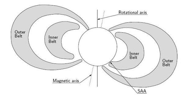

RADIATION ENVIRONMENT
Radiation in the space environment comes from the trapped particle belts, solar particle events and cosmic rays.

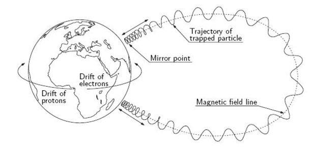

Trapped Particle Belts
The radiation belts consist principally of electrons of up to a few MeV energy and protons of up to several hundred MeV energy. These are trapped in the Earth's magnetic field; their motions in the field consist of a gyration about field lines, a bouncing motion between the magnetic mirrors found near the Earth's poles, and a drift motion around Earth.
Basic motion of trapped particles in the Earth magnetic field
Radiation is an obvious concern for manned missions. In the near-term, manned activities are limited to low altitude, and mainly low-inclination missions. The International Space Station (ISS), Space Shuttle, EnviSat and other low altitude missions will therefore encounter the inner edge of the radiation belt. This region is dominated by the "South Atlantic Anomaly (SAA)" - an area of enhanced radiation caused by the offset and tilt of the geomagnetic axis with respect to the Earth's rotation axis.
Earth radiation belts with the South Atlantic Anomaly indicated
Besides the SAA, the polar horns also play a role for radiation analysis at low altitudes (e.g. ISS type orbit). Polar horns are parts of the outer radiation belts, which are close to Earth. As can be seen in the simulation below, increased radiation flux due to the polar horns can be expected between 60 and 90 degrees lattitude. The SAA is clearly visible at the South Antlantic region around 30 up to 50 degrees lattitude.
ed_electron_flux_at_380_km_altitude_the_polar_horns_and_South_Atlantic_Anomaly_are_evident_large.jpg
