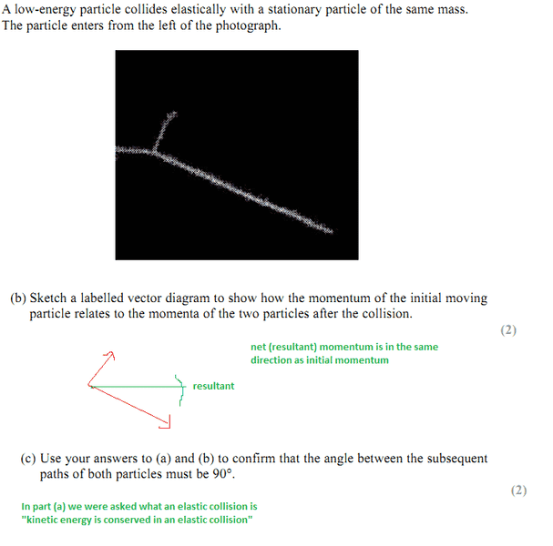

Please could someone check my vector diagram
could someone also help me with part (c)
azizlwl said:Part c.
Use conservation of energy.
Steely Dan said:What is the condition for two vectors to be perpendicular to each other?
space_buster said:Please specify perfectly elastic or partially elastic ?
jsmith613 said:there vector sum = initial magnitude
Steely Dan said:Well, that's the condition for conservation of momentum. It's not a direct proof that the paths are perpendicular to each other. A direct proof of that is to take the inner product (or dot product, depending on what you call it) of the two final momentum vectors, and ensure that the result is zero (that is the definition of perpendicular vectors).
