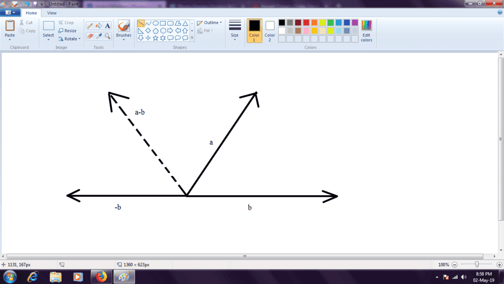

The angle between two vectors a and b (along the adjacent sides of a parallelogram) is an acute angle. The vector a-b will be (a)major diagonal of parallelogram (b)minor diagonal of parallelogram (c)none
Vector diagram
We know that the sum of the two vectors is represented by the major diagonal.
Now, if I draw the vector diagram, it turns out to be a diagonal of an entirely different parallelogram. So, my first answer was (c) none.
But, I noticed that when parallelly shifted, it turns out to be the minor diagonal of the above parallelogram. So, I switched to (b).
But the correct answer according to my book is (a).
Can anyone explain this?
Have you drawn a diagram? Identify vectors a and b and then -b.
242827
It should look something like this. How should I proceed now?

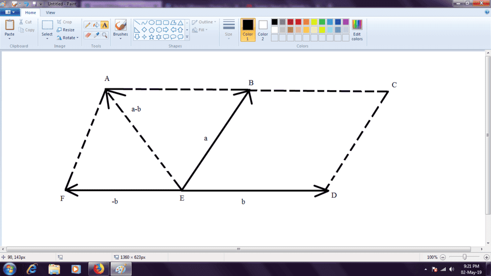

Complete the parallelogram and draw its diagonals. Then you you will see what's going on.
242829
I still see it as the minor diagonal of ABEF. Please help me.
The answer in your book is wrong. That's why you are so confused.
Oh, I see.
So what's it going to be?
I am still on (b).
Oh, I see.
I am still on (b).
(b) is correct.
