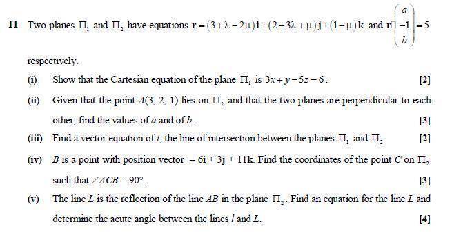

I'm at (iii) of the question.
I've got the different ans.
[tex]
Aug=
\left( {\begin{array}{cccc}
2 & -1 & 1 & 5 \\
3 & 1 & -5 & 6 \\
\end{array} } \right)
[/tex]
[tex]
rref=
1 & 0 & \frac{4}{5} & \frac{11}{5} \\
0 & 1 & \frac{-13}{5} & \frac{-3}{5} \\
\end{array}} \right)
[/tex]
Hint: The cross product of the normals is in the direction of the line of intersection. (Why?)
i'm at part 3 . Thanks by the way. I've got my doubts cleared. (=
