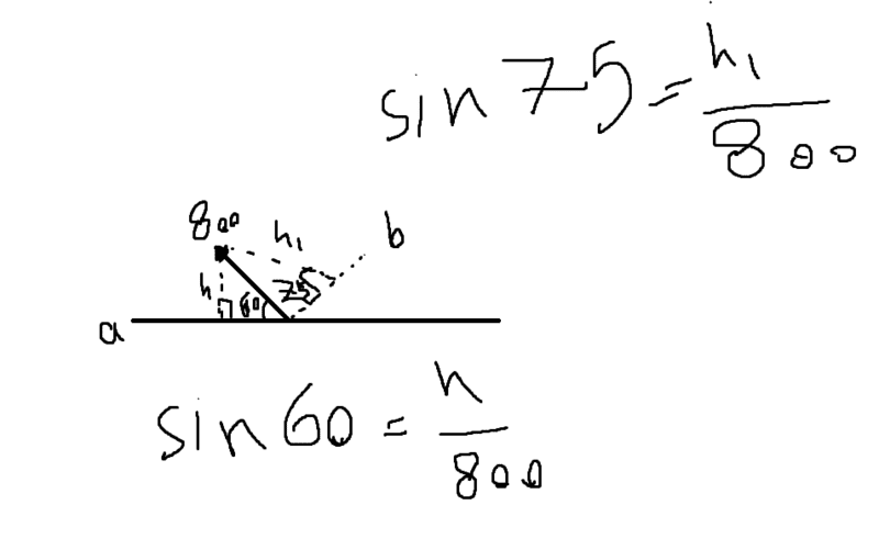

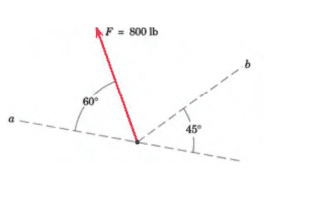

The components of the force of 800 lb F along the non-perpendicular axes Get a, b. Also determine the image F on the axes a, b
could some one help me how to resolve forces non-perpendicular.And also what is the meaning of image F one the a,b axes
sHatDowN said:
Homework Statement:: Force image and resolve force
Relevant Equations:: vector
You find the components along ##a## and ##b## the usual way. Draw perpendicular lines from the tip of ##F## to the two axes. This will give you two right triangles. Then proceed as usual.
I suspect the "image of ##F##" means find the components of ##-\vec F## along axes ##a## and ##b##. That is consider the reflection of ##\vec F## about a mirror plane that is perpendicular to it. Others may have a different opinion.

Thanks sir,
I Find F to a =692.82
and F to b =772.74
is that correct?
kuruman said:
I suspect the "image of " means find the components of along axes and . That is consider the reflection of about a mirror plane that is perpendicular to it. Others may have a different opinion.
I have same opinion but still i dont know what should i do.
sHatDowN said:
Is that correct?
It doesn't look correct. Please show how you got these numbers and include your drawings.
The vector should be the hypotenuse. Try to draw this more to scale. Your 75° angle looks like a right angle. Your trig ratios are incorrect. You need to review them.
If you want the component of F in the direction of a, you want the portion of F that is parallel to a, not the portion of F that is perpendicular to a.
Then its 400
is that correct?
A few thoughts…
The required components of ##\vec F## are ##\vec a## and ##\vec b##. This means ##\vec a + \vec b = \vec F##.
(The question requires only the magnitudes of the components, i.e. ##a## and ##b##.)
To find the components, a simple approach is to draw the vector-addition triangle (or parallelogram). This gives a triangle with all three angles known and one side of known length. (The triangle is not a right-triangle.) The rest is simple trig’.
For the question about the ‘image’ I’d guess:
“… determine the image F on the axes a, b”
is very badly/incorrectly written. The intended meaning is possibly:
“… determine the projections of ##\vec F## on the axes of ##\vec a## and ##\vec b##”
The reason for the above interpretation is that the question could be about making the student aware of the differences between perpendicular and non-perpendicular components of a vector.

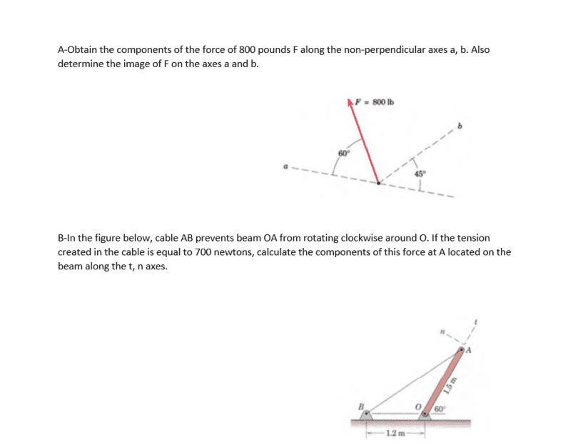

@sHatDowN , are you sure you have quoted the whole question exactly?
@sHatDowN What is the source of this question? From where did you get the image you posted in the OP?
and its B part of question
and AO is cable which is 700N
Calculate the components of this force at A located on the beam along the t, n axes.
still i have confusion:(
Ok, but I struggle to relate the two parts. Are you sure you quoted part B in post #1 word for word? "The components of the force of 800 lb F along the non-perpendicular axes Get a, b." doesn’t read like that to me.
Any chance of providing an image of the whole question?

sHatDowN said:
the AB cable prevents the rotation of the beam OA clockwise around O. If the tension created in the cable is equal to 700 newtons, calculate the components of this force at A located on the beam along the t, n axes.
and this is what is the B part
So how did you arrive at the diagram in post #1? Is that provided with the question or did you draw it? Where does the angle of 45° come from?
In post #1 you wrote "how to resolve forces non-perpendicular", but ##t, n## are perpendicular.
It really would help enormously if you would post the entire question in a single image.

sHatDowN said:
Ok, thanks, that explains it. I read your posts as saying the parts were in the other order, but I see now it was ambiguous.
Also, "get a, b" is not in the actual question. That clears up the puzzle that there is no provided coordinate system.
Neither does it say anything about resolving into components. It only asks you to find components in two given directions.
Various responses in this thread have been correct in themselves but addressing different tasks. I'll try to clarify.
You can find the component in the direction of ##\vec a## as @kuruman described in post #2. Independently, you can find the component in the direction of ##\vec b## by the same method. But those two will not add up to equal the original vector, so it does not constitute resolving into components. You added that word in post #1, which has created all the confusion.
You can resolve the force into components in the directions of non perpendicular ##\vec a, \vec b##, but it requires a different method. You cannot do it independently for the two directions. I don’t think this is what the question is asking for.
As an aside, resolving into non-perpendicular components drops out nicely in three dimensions because you get to use the cross product. If ##\vec v=\alpha_1\vec x_1+\alpha_2\vec x_2+\alpha_3\vec x_3## then ##\alpha_1=\frac{[\vec x_2, \vec x_3, \vec v]}{[\vec x_1, \vec x_2, \vec x_3]}##, etc., where ##[\vec a, \vec b, \vec c]=\vec a\cdot(\vec b\times\vec c)##, the triple scalar product.

Since the only connection with part A is subject matter, it belongs in a separate thread.
But the first step is to draw a free body diagram for the beam. Note all the forces acting on it and consider what equations are implied by equilibrium.
Edit: can you do part A now?
