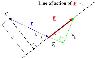

I don't understand how you can calculate the torque just by using horizontal tension and the vertical distance instead of a force that is perpendicular to the surface.

What surface? You're trying to calculate the torque created on the beam by the tension in the cable, which has two parts:
1. The moment arm is the vertical distance (3 * L / 4) * sin(65°) between the attachment point of the cable and the pivot, and the force is the horizontal component of the tension in the cable, T*cos(25°).
2. The moment arm is the horizontal separation of the attachment point of the cable to the boom and the pivot point, (3 * L / 4) * cos(65°), and the force is the vertical component of the cable tension, T * sin (25°).
The calculation of the total torque about the boom pivot is split in this manner due to the definition of the moment of a force about an axis of rotation.
In the diagram below, the moment of the force F about O is M = F × d:

ok I have finally get it. Thanks!
