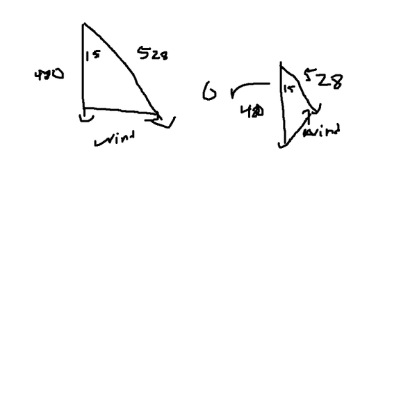

A plane initially flies south at a velocity of 480 km/h. Aided by a wind, the groundspeed is 528 kmh at 15 degrees east of south.
Calculate the windspeed and the direction of it
I got the magnitude of 139.9 km/h but for the angle I Don't know if the angle is down below the horizontal or above the horizontal.
I don't know which way you're measuring the angle. Pls post your working.
Yes, Like this
ok, that's a diagram, but somehow you calculated a speed. Presumably you created an unknown for an angle (which angle?) and wrote down some equations. pls share.
Ok I did cos law: Wind = √ (528)^2 + (480)^2 - 2(528)(480)cos15 = 139.9
Ok, so pick an angle in the diagram that you want to compute and write down an equation involving it and known distances.
I used the sine law: sintheta/528 = sin15/139.9 = 77.53 degrees... So the picture where the wind goes up?
Ok, so you are measuring the wind angle as E of N, and you get 77.5 degrees. Seems reasonable.
Well, the longest side of the vector triangle is 528 m, so the greatest angle has to be opposite to it. If one angle is 15° and the other is 77.5°, the third angle is 87.5°: the greatest angle in the triangle, and it is opposite to the side of middle length. So choose 180-77.5 as the angle of the wind.
