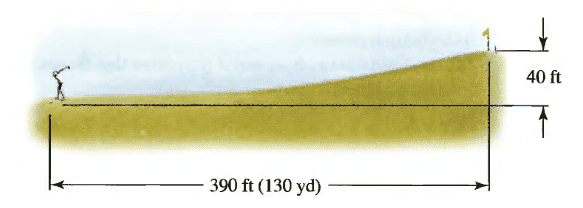

A golfer stands 390 ft (130 yards) horizontally from the hole and 40 feet below the hole. Assuming the ball is hit with an initial speed of 150 ft/s, at what angle should it be hit to land in the hole? Assume the path of the ball lies in a plane

3. Now, do we set the position function equal to the vector <390, 40>, and somehow solve for theta? Any advice on how exactly I can do that?
You are not integrating over θ so the position function you have is wrong.
But, yes, you would then set i equal to the vector <390,40> to see what you get for θ

p(t) = <150tcos(θ), 150tsin(θ) - 16t^2>
However, setting the equation equal to <390, 40> doesn't really seem to make sense because I have both theta and t. Do I need to get t out of the equation and make it entirely in terms of theta? How do I go about that?

Yes, you can equate ##\underline{P}(t)## to ##\langle 390, 40 \rangle##. This will give two scalar equations and if you eliminate t between the two equations, you can get ##P_y = 40 = P_y(\theta)##, I.e the displacement in the vertical direction as a function of the angle projected, which you can solve.
