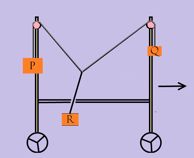

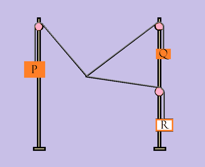

My experiment is like this picture found in the net. The weight in the middle is called R in my experiment, while the left one is P and the right Q.
Now there is one question asked, the answer of which is needed to be included in the report.
It goes like this: "the direction of ALL the resultant vector R=( l P+Q l ) must be the same. If you want the direction of the resultant vector R to be different, what should you do to the arrangement of apparatus in Figure 4? (Use your own creativity / creative thinking)"

The mass is currently hanging down vertically due to gravity. Can you think of a way to get it to hang at say 10 degrees to the vertical? Hint: You might not be able to do it in a confined space or for very long.

I was actually thinking of putting the rig on wheels and accelerating it horizontally.
Do you mean like this, Sir?
Because I don't really understand...
No I mean put the whole rig on wheels and accelerate it across the lab like this..
OH...
Oh sorry Sir, forgive my stupidity. Yes you have solve the problem! Since day 1...
