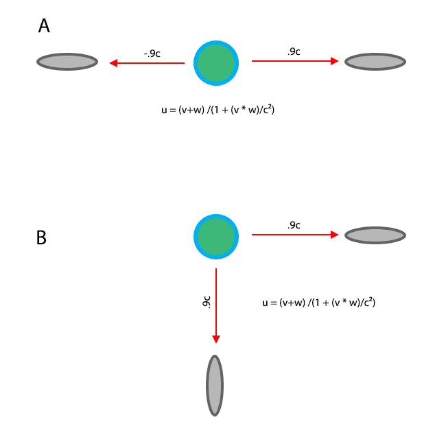

Scenario A:
Two ships are each receding from Earth at .9c in opposite directions. Since these are velocities, they should have opposite signs.
That can't be right, since they immediately cancel out in (v+w) to get zero.
Scenario B:
The two ships are receding orthagonally from Earth.
I thought this would be a simple case of finding the hypotenuse, but that leaves me with one number: 1.27 I need two numbers to apply the formula.
Where am I going wrong?

In the first case (scenario A), from left ship point of view, Earth is going to the right, and right ship is going "even more" to the right. So there's no need to use one +ve and one -ve.
i.e. from the perspective of one ship, Earth and the other ship are going in the same direction.
From Earth point of view, where one ship is going left and one is going right, no relativistic addition is needed.
In the first example, call the two ships L for left and R for right.
L’s speed relative to R is the earth’s speed relative to R plus L’s speed relative to earth. That’s a plus sign for the same reason that you’d add the speeds using Galilean relativity.
The second example is trickier because you can’t just naively divide the velocity of the downwards-moving object into x and y components using the frame in which the left-mover is at rest and then transform the x-component. You’ll find the right formulas in the Wikipedia article in the “Standard configuration” section: https://en.wikipedia.org/wiki/Velocity-addition_formula#Standard_configuration. As with the previous example, you get the signs right by asking yourself “should increasing this speed increase or decrease the final result?”

In this simple case, You can treat the Earth and downward moving ship as a system moving to the left at 0.9c relative to the ship shown moving to the right from the Earth frame.
This whole system is subject to time dilation. So, According to our "right moving" ship, the vertical component of the other ship is ~ 0.436 x 0.9c = 0.3924c Then the Pythagorean theorem can be used to get the resultant velocity according to our ship of choice.
Thus if v is the horizontal ship's velocity with respect to the Earth and w the vertical ship's velocity with respect to the Earth, then the relative speed between the two ships as measured from the horizontal ship is:
## u = \sqrt{ v^2 + \left( \sqrt{1- \frac{v^2}{c^2}}w \right)^2 }##
Which reduces to
## u = \sqrt{ v^2 + w^2 - \frac{vw}{c^2}} ##

It appears your next to last formula is correct, but you made a mistake in your last formula.
Oops, you're right, I forgot to square That last term under the radical. :sorry:
It should be
## u = \sqrt {v^2 + w^2 - \left ( \frac{vw}{c^2} \right )^2}##
It should be
Hate to say it, but still not quite right. The third term under the radical should be v2w2/c2. You can see this either by units consistency or by correct algebra from the prior equation.
