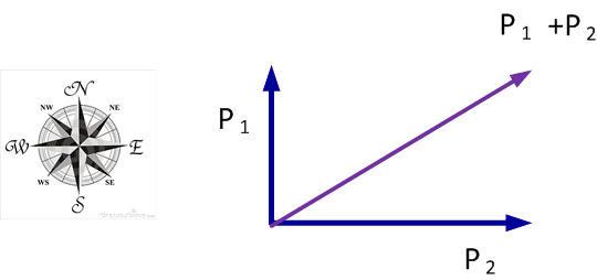

A 2000-lb car traveling north at 60 mph collides with a 5000-lb car traveling east at 40 mph. The cars stick together after the collision. Find the velocity (magnitude and direction) of the cars just after the collision.
conservation of linear momentum
Firstly, I need to find the masses of each car. Car 1 has weight of 2000 lbs and has a mass of (2000/32.2) about 62 slugs. Car 2 has weight of 5000 lbs and has mass of (5000/32.2) about 155 slugs. That said, the initial momentum of car 1 equals m(1) times v(1) or (62 slugs times 60 mph) = 3720 slug-m/h. Initial momentum of car 2 equals m(2) times v(2) or (155 times 40 mph) = 6200 slug-m/h. So the total initial momentum is 9920 slug-m/h.
The final momentum of the cars= (total mass of cars since they stick together) times (new velocity) which equals 217v, so v= 9920/217 or 45.7 mph. To find the direction of velocity after collision, wouldn't I do arctan(40/60) = 33.7 degrees NE.
Now I must be doing something wrong because in the back of the book, the answer is 33.3 mph at 31 degrees NE. So i can't figure out what I'm doing wrong.
You cannot add momentum in different directions linearly.

(1) Nevermind the units; just use masses of m1 = 2 and m2 = 5. Converting to thousands and slugs serves not purpose in this problem, since you are just multiplying and later dividing by a constant.
(2) The initial momenta of the two cars are VECTORS pointing in different directions, so you need to represent them by their x- and y- coordinates; You cannot simply add up their magnitudes.

Hello S,
Why you want a mass in slugs is a mystery to me. Never mind.
Momentum is a vector. You can't add the components like this: they are at right angles to each other !
So do a vector addition and use Pythagras to find the total momentum.
The tangent of the direction angle is the y momentum divided by the x momentum

Oh ok. So i calculated the net momentum by pnet= p1 + p2 and that gave me 233. Then to find the resultant velocity I I did v=(233)/7 = 33.3 mph. Now I can't seem to find the direction. I thought it would be arctan (3) but that's not correct.
I figured the answer out. Now I need to spend quite some time figuring out and learning THE PROCESS to get the answers. Knowing that momentum IS a vector it has vertical and horizontal components. So initial momentum^2= P(ix)^2 + p(iy)^2 and so p(i)=sqrt of all of that. Then to find p(f) i need to do the same thing but note that mass=M=combined mass of the two cars. From momentum conservation I know that the COMPONENTS of initial and final momentum equal one another. Doing this I can solve for final vertical velocity and final horizontal velocity. Knowing these I add the sum of their squares and then sqrt that to find final velocity vector. To find its direction I just do arctan (final vertical velocity/final horizontal velocity). HOWEVER, I'm still confused why I can just use pounds instead of slugs in this question. Since i need to find the momentum of each car I need to use their mass (but pound is a measurement of weight and slugs is a measurement of mass). That's why I converted pounds into slugs. because isn't momentum measured in kgm/s in SI units? That is mass times velocity, so how would (pounds miles an hour) be just as useful as (slugs miles and hour) if slugs measure mass and pounds measure weight?
Why 3? It's the momentum ratio you want, not the velocity ratio.

57
29
619
