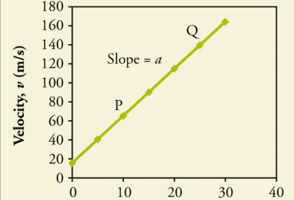

It doesn’t feel like you posted the entire question, but maybe all you left out was "Find".
How would you go about finding the initial velocity and acceleration from the position/time graph?
But to answer your question, no, the two graphs represent different motions.
How would you go about find the initial velocity and acceleration from the position/time graph?
The graph is just an example to show the type of motion it travels. I just want to know whether the acceleration and initial velocity will be same for both position/time graph and Velocity time graph

And I answered that (from the data in these graphs) they will not be.
haruspex said:
And I answered that they will not be.
may i know why? because i get around the same value for acceleration and initial velocity based on experiment I got a = 0.200 (for postion/time graph) and a =0.203 (for velocity/time graph). I also get Initial velocity = 0.0711 (for postion/time graph) and Initial velocity = 0.0811 (for velocity/time graph)
If you've both ##d:t## and ##v:t## graphs representing the same experiment, they will both show the same thing regarding velocity. (The two graphs you give as an example are not for the same experiment).
Of course, you can't get initial displacement from a velocity graph.

I think I misunderstood your post 3. See my edited post #4. (I don't see why you posted those two graphs with the question - it's just confusing.)
Yes, if you are looking at such graphs from the same experiment, which the graphs you posted are not, then of course you should in principle get the same answers to whatever questions you pose. But it might be quite difficult to extract accurate values in some cases.
For the initial velocity, that is very difficult to read off the s/t graph directly. Since you are assuming acceleration is constant you could pick three data points and solve the quadratic. That will give the acceleration too.

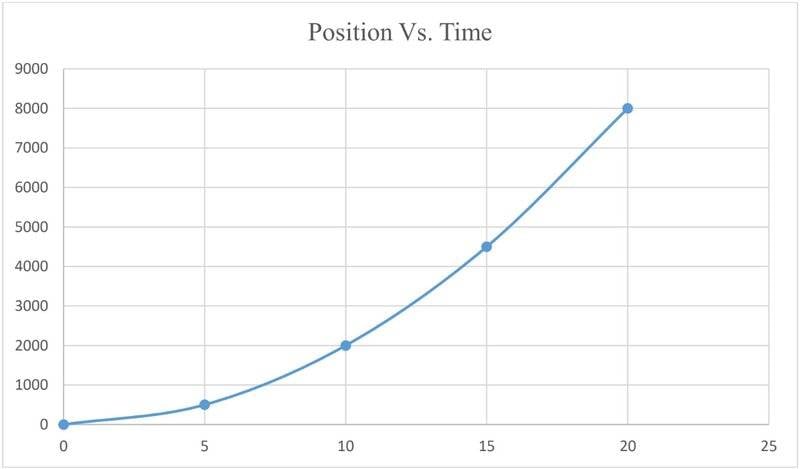

Assuming uniform acceleration for the top graph, then solving x = ½at2 for a , using the point (20,8000) gives a=40 (units unknown).
Eyeballing the bottom graph for P(10,65) and Q(25,140) then calculating slope gives a=5m/s2 , so not the same experimental data as in the top graph.

If you read through the thread you will find the posted graphs are irrelevant to the question being asked. Ignore them.

The points on the provided position versus time graph are very nicely patterned. The five y coordinates are at 0 hash marks, 0.5 hash marks, 2.0 hash marks, 4.5 hash marks and 8.0 hash marks. Double each of them and that is 0, 1, 4, 9, 16. It does not get much more obvious than that.
An exact five point fit to a quadratic model where the data points all hit hash marks on round numbers. That makes it likely that the data was fudged by an instructor rather than measured from an experiment.
We seem to have a parabola with its apex at (0, 0). The conclusion is that the initial velocity for that particular position versus time graph is zero.

Yes, but, as has been discovered in the course of this thread, the posted graphs are irrelevant and should be ignored. We do not have the actual data that gave rise to the question.
