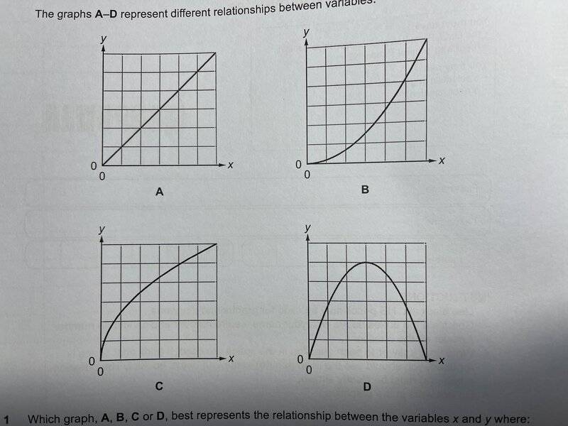

Which graph, A, B, C or D, best represents the relationship between the variables x and y where:
y is the velocity of an object falling freely from rest, x is the distance fallen?
I attach choices of graphs below.
Equations of motion
My reasoning:
Gradient of graph = v/s = t
t increasing therefore gradient increasing
So graph B
The answer is C.

Hi,
v/s = t is only true if v is constant. In free fall v is not constant.
If you write down equations for x and y as a function of time you can eliminate t to find v(s) .

g9WfI said:
v/s = t
If you divide metres per second by metres, what do you get?
Ah - 1/t
So as t increases, gradient decreases.
So answer is C.
I get v = 9.8 x √ (s/4.9)
Putting that into a graphing calculator I get a graph which looks like C, but I wouldn't have been able to recognise that myself :/
It makes sense if you think about energy. For a given distance, the loss in GPE is constant: in this case ##mg\Delta x##.
But, the increase in KE is ##\frac 1 2 m[(v + \Delta v)^2 - v^2] = \frac 1 2 m\Delta v(2v + \Delta v)##.
As ##x## increases, ##v## increases and the change ##\frac{\Delta v}{\Delta x}## must decrease.

As @BvU notes, v/s=1/t is only true for constant velocity. More generally, ##v_{avg}/s=1/t##, but that is with v averaged over time. There is no easy way to relate that to the instantaneous v used in the graph axis.
If you write it instead as ##v^2=2gs## you should recognise that as a parabola. Setting y=2gs and x=v it gives the classic ##y=x^2##, so you should be looking for that graph but flipped around, swapping the x and y axes.
