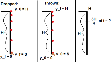

Suppose you drop a ball from rest out of a window that is at height H above the ground, and suppose the ball hits the ground with speed S.
At the instant that you release the ball, your buddy throws a ball straight up from the ground level with the same speed S.
Show that the balls pass each other at a height of 3/4H
What we know: for person dropping the ball
##y_o = h##
##y_1=h##
##a_y=-9.81m/s^2##
##v_0=0m/s##
##v_y = S##
Person launching the ball up:
##y_o = 0##
##y_1= h##
##a_y=-9.81m/s^2##
##v_0= S##
##v_y = 0m/s##
##v_y = v_0 + a_yt##
##y=y_0+v_0t+1/2a_yt^2##
##v^2_y = v^2_0+2a_y(y-y_0)##
##y-y_0=1/2(v_0+v_x)t##
## v^2_y-v^2_0=2a_y(y-y_0) ##
So my thought process is I need to use a kinematic equation to solve for a value let's say t, for both people, one dropping the ball and one throwing the ball.
Eq.4 ## y-y_0=1/2(v_0+v_x)t ## -> ## t=2(y-y_0)/(v_0+v_y) ##
so now that we have an equation for a function of time, my thought process is that the time when the person throws the ball the height should be 3/4H. I'm not sure if I can do this, but I'm hoping I can set v_y = 0, I think I can use it for the person dropping the ball, but not for the person throwing the ball, but I got stuck here if I didn't.
##t=2(3/4H)/(S+0) ## -> t = 3H/2S
Then for the person throwing the ball down
## t= 1/2(1/4H)/0+S ## -> t=H/2S
then when you set them equal to each other you get H/2s = 3H/2s -> 3
I'm hoping in some way shape or form that is still a t, then to test my answer I plug t=3 into equation 4 again.
##dropping: y-y_0= 1/2(v_0+v_y)t## -> ## 1/4H= 1/2(0+S)3 ## -> ##H=6S##
##throwing: y-y_0 = 1/2(v_0+v_y)t ## -> ## 3/4H=1/2(S+0)3 ## -> ##H=2S##
Set them equal to each other to get 3 again. I think at this point its a huge stretch, and it's probably just an algebra reason why I got 3 again. I'm not sure how else to approach this.

Hello Mathias, welcome to PF :smile:
You've done your best to approach this systematically and sorted out things nicely. I suppose the first ##y_1=h## is a typo and you mean ##y_1 = 0## ?
S is an unknown that can be found using your first two equations (ball falling). If you work them out you get the third equation: it gives ##S^2##. You also get ##t_{total}##, the time to fall from h to 0.
Why? It clearly says both start at the same time !
Is a total mystery to me. What does that mean ? H = 3 ?

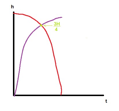

A good thing to do is make a sketch of h versus time for both trajectories. The point where the balls pass each other is where the two lines cross ! At that point in time (i.e. at that value for t) you have ##y_{down} = y_{up}##.
Since you have expressions for both as a function of t, this should solve nicely. From what is asked, it is clear that the only thing that doesn't fall out is h.

BvU was recommending looking at a sketch and noticing something from the symmetry, namely, where they are in relation to each other at the half time mark.
So if I understand you correctly t = 1/2 at 3H/4 for both, dropped and thrown.
However I am conflicted with that because the dropped ball just goes straight to the ground, But for the ball that is thrown it get to the max height (H) then falls down again. So t total of thrown would = 2, compared to the other, so if you then set them equal to each other that's you you would get dropped: ##t_d##, thrown: ##t_r## ##2t_d = t_r ## ## t_d/t_r=1/2## is where they would meet then, and at that time 1/2 is where the height 3H/4, not sure I understand that now but I'll play with that idea. That then brought me to an idea of something we did in calculus when measuring are area under the curve, we had two curves which would cross as a point (3H/4) then would subtract the 1 curve from the other. If those curves where velocity time curves then if area under the curve is an integral then the integral of the velocity curve would yield total x position, or just current x position.
Mathias said:
So I understand you correctly t = 1/2 at 3H/4 for both,
No, we're not saying it's necessarily 3H/4 (yet). Have you drawn a height versus time diagram showing both trajectories? What does it look like? Do you see a symmetry?
Yes, but we don't care what happens after the thrown ball reaches maximum height.
I imagine it would look something like that. Where red is dropped, and purple is thrown. But this is just going off of the idea of what the effects of gravity would be. I guess what I would discern then is that the functions would be (inversely proportional)? I'm not sure if that's the right word. I suppose from my graph one could say that 3H/4 = t/2 but I wouldn't know how to discern that myself without the maths in front of me that would suggest something like that, if this is the case do you know what I could search for to research it?
Yes, the diagram is right, but don't rush into 3H/4 - that's what we have to prove. What you can say from the symmetry of the picture is that they cross over at time t/2. Now all you have to do is calculate what fraction of the height the falling ball covers in half the time. That should be easy from the SUVAT equations.

When the balls pass each other, they are at the same height at the same time t, so we equate the two:
## y = h - {1\over 2} gt^2##
## y = St - {1\over 2} gt^2##
Obviously ##h = St## which gives us ##t##. We fill it in in the equation for the trajectory of one of the two and voila.
Note that -- having seen the sketch -- we didn't make use of the symmetry, but we sure would do well to check that indeed ##t = \tau/2##.
