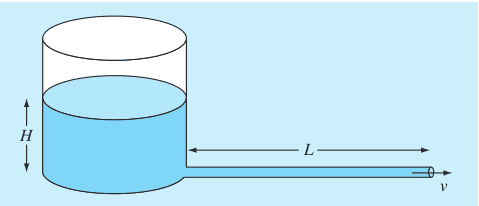

Trying to understand the origin of a velocity equation by deriving it.
I was not really sure as to whether to ask this question here or the h/w forum as its something I am personally trying to understand. However, I shall let the admin decided.
The question comes from a book called :
Numerical Methods for Engineers by Steven C.Chapra and Raymond P.Canale
. The specific question I have an issue with is not the question itself but the equation given within the actual question. For those of have access to the book, it is on page 142, prob 5.15.
Here is the actual question along with the given diagram:
As depicted in Fig. P5.15, the velocity of water, v(m/s)v(m/s), discharged from a cylindrical tank through a long pipe can be computed as:
##v=\sqrt{\left(2gH\right)}\cdot tanh\left(\frac{\sqrt{\left(2gH\right)}}{2L}t\right)##​
Diagram
What I have been trying to figure is where this equation comes from. Now granted my fluids knowledge is not fantastic, which is why I am trying to figure out how to derive this equation as a learning opportunity.
So in my effort to try and derive the equation I have been using an old text I used in the past along with a lab report I found online, but I am still drawing blanks in how this equation been derived.

Taylor_1989 said:
Summary:: Trying to understand the origin of a velocity equation by deriving it.
v=√(2gH)⋅tanh(√(2gH)2Lt)v=(2gH)⋅tanh((2gH)2Lt)v=\sqrt{\left(2gH\right)}\cdot tanh\left(\frac{\sqrt{\left(2gH\right)}}{2L}t\right)​
Hi
You do realize that the equation is about the transient motion of the fluid from time t-0 to steady state.
A mass acted upon by a force from initial velocity zero takes some time to reach a particular final velocity.
Here you have packets of dm of fluid entering the tube, being accelerated by the force from the pressure.
If you take time intervals of Δt for each packet to enter the tube, the force accelerates the first packet, then another packet enters after 2Δt and both packets are accelerated by the force, then after 3Δt another packet enters, and so on.

I didn't at the time it was about transient motion, but after reading your comment I did a little bit more research and came across the Unsteady Bernoulli Equation which has to do with transient motion, I am not sure if this will result in the given equation that I posted above but it does seem hopefull the more I read.
I honestly I have never really gone into fluids the deep before but, I am finding it a fansinating subject.
Likes 256bits
There is a good discussion from the guys at MIT regarding your equation,
https://ocw.mit.edu/courses/mechani...ow-and-bernoulli/MIT2_25F13_Unstea_Bernou.pdf
Note the stipulation"large tank", and long pipe. Large tank so that the head, h, does not vary considerably as the flow exits, and the long pipe so that the time constant becomes "reasonably realistic".
Compare that with this discussion where the head h does drop as the flow exits.
Note that they mention the a/A ( area of pipe/area of tank stipulation, which is your case is small.
For their discussion the length of pipe is short or non-existent.
I am assuming they are correct in their derivation.
https://physics.stackexchange.com/q...rect-to-use-bernoulli-and-continuity-equation
