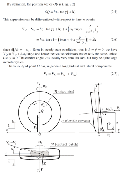

I am trying to solve for change in velocity for the center of a rim with respect to the contact patch of a tire that has some degree of camber. The equation finalized is shown in the image below, equation 2.6.
http://imgur.com/a/oHucp
I understand how to get the position vector shown in 2.5. The first part of 2.6 is just deriving 2.5 with respect to h. The 3rd and 4th terms are what confuse me. In regards to dj/dt = -wz i, I understand that the change in j with respect to time is directly related to the yaw moment (wz) but what is the mathematical reasoning for using the i unit vector? Further, the 4th term demonstrates that dk/dt = -γ' / cos2 γ j, showing that k = -tanγ.
Sorry for the improper notation, was hoping to get further insight into how these terms are being derived.
I can't see your figure, and without that, there is no good way to reply to you. Please get the figure into the post.
Sorry about that, should be fixed.
