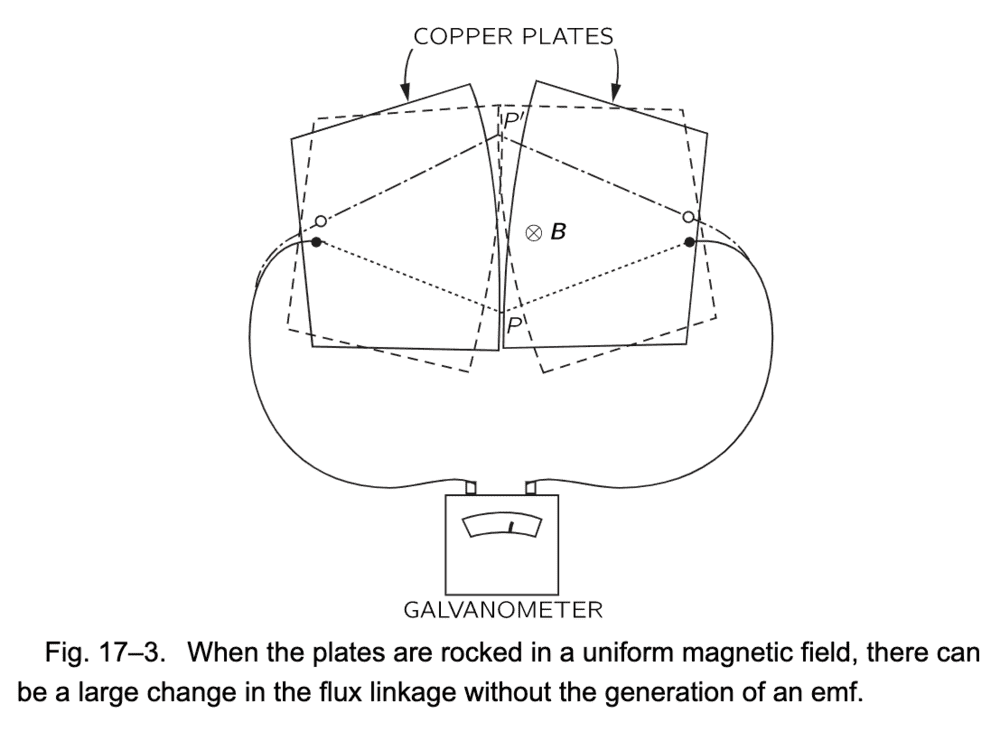

Whilst I was reading yesterday I also found a really interesting discussion in Feynman Vol. II Chap. 17 which gave some exceptions to the 'flux rule'. In that whilst ##\oint_{\partial \Sigma} \vec{E} \cdot d\vec{x} = -\int_{\Sigma} \frac{\partial \vec{B}}{\partial t} \cdot d\vec{S}## is a fundamental law which always holds for any surface ##\Sigma## and bounding curve ##\partial \Sigma##, the 'flux rule' ##\oint_{\partial \Sigma} \left( \vec{E} + \vec{v} \times \vec{B} \right) \cdot d\vec{x} = -\frac{d}{dt} \int_{\Sigma} \vec{B} \cdot d\vec{S}## will only work if ##\partial \Sigma## coincides with the real conducting material! There was an example here of where the flux rule fails (here because the current is not restricted to a thin curve, but moves within an extended volume!):
Yes, in such cases it's also better to use the local (macroscopic) laws. In such cases you have to use also the full Ohm's Law, (in SI units)
$$\vec{j}=\sigma(\vec{E}+\vec{v} \times \vec{B}).$$
The usually neglected term with the magnetic field takes into account the Hall effect. Feynman is among the best books concerning these issues of E&M though it's not true that any law doesn't hold. It only has to be applied correctly. He is right in saying that the complete set of equations are given by the Maxwell equations and the Lorentz force.
