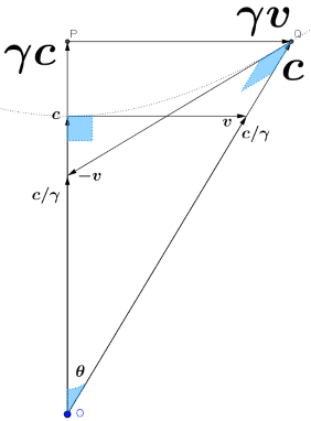

I have read that the velocity of a body through spacetime is equal to 'c'.
Can I therefore draw a spacetime velocity diagram (triangle) with sides: "v" velocity through space.
"c". ------------------ time
"c" ------------------ spacetime?

No. The "velocity through spacetime" ##c## is the length of the object's 4-velocity vector. You can draw a triangle in velocity space with this as one side, and the second side being the spatial velocity ##v##; but the third side will not be ##c##.
Here's a spacetime diagram
In trigonometric form,
[itex]v/c\quad\ =\tanh\theta=\frac{opp}{adj}[/itex]
[itex]\gamma\qquad \ =\cosh\theta =\frac{adj}{hyp} [/itex]
[itex]\gamma(v/c)=\sinh\theta =\frac{opp}{hyp} [/itex]
(I updated the diagram by indicating the rapidity [itex]\theta[/itex] (the Minkowski-analogue of the angle).
By the way, the rapidity of the Minkowski-right-angle is infinity.
I also added the interpretation of "tangent" as "opposite over adjacent", etc...
Also note: the tangent-line to the Minkowski-circle is Minkowski-perpendicular to the radius.)

Thanks very much, although I not quite sure how much it will actually help me in what I am trying to do as the diagram has 'c' and 'v' at right angles. I am working on an idea which seems to suggest that, despite Minkowsky, the Angle is variable and cannot exceed 90 deg.
RC
Do be aware of PF rules on personal theories. In summary, take it to a journal - we do not discuss them here.
The diagram @robphy posted shows a four velocity (diagonal arrow, length ##c##) with its time component (vertical line, length ##\gamma c##) and its spatial component (horizontal line, length ##\gamma v##). And ##c^2=(\gamma c)^2-(\gamma v)^2##. There are a number of other things shown on there relating to other frames, but those are the relevant bits.
The angle robphy mentions is also called the rapidity, and is a way of representing velocities and gamma factors. It does, of course, vary with velocity.

I forgot to mention rapidity and draw it in the diagram. It's updated now. Thanks.

Sorry, but I can't see what significance the equation has:
(a). It simplifies to: c^2= c^2 (b). It only has one variable. i.e. 'v'.
The right hand side is an explicit statement of the modulus-squared of the four-velocity. This is indeed ##c^2## whatever the value of ##v##.
[itex]c^2 = (\gamma c)^2 - (\gamma v)^2[/itex]
is essentially the statement that
[itex]c^2 = (\cosh^2\theta) c^2 - (\sinh^2\theta) c^2[/itex] using the rapidity (the Minkowski-angle) [itex]\theta[/itex],
which uses the identity [itex]1=(\cosh\theta)^2 - (\sinh\theta)^2[/itex], effectively identifying the hyperbolas as the "circle" in Minkowski spacetime/Special Relativity.
The Euclidean analogue of the above is
[itex]1=(\cos\theta)^2 + (\sin\theta)^2[/itex], where [itex]\theta[/itex] here is the ordinary angle.
This shows up in introductory physics when we express the magnitude of a vector in terms of its x- and y-components.
If we express this in terms of slope [itex]v[/itex] instead of angle [itex]\theta[/itex],
we would write
[itex]1=(\frac{1}{\sqrt{1+v^2}})^2+ (\frac{v}{\sqrt{1+v^2}})^2[/itex]
So, in special relativity, we have the analogue
[itex]1=(\frac{1}{\sqrt{1-v^2}})^2- (\frac{v}{\sqrt{1-v^2}})^2[/itex]
associated with expressing the magnitude of a spacetime-vector in terms of its t- and x-components.
