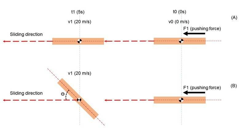

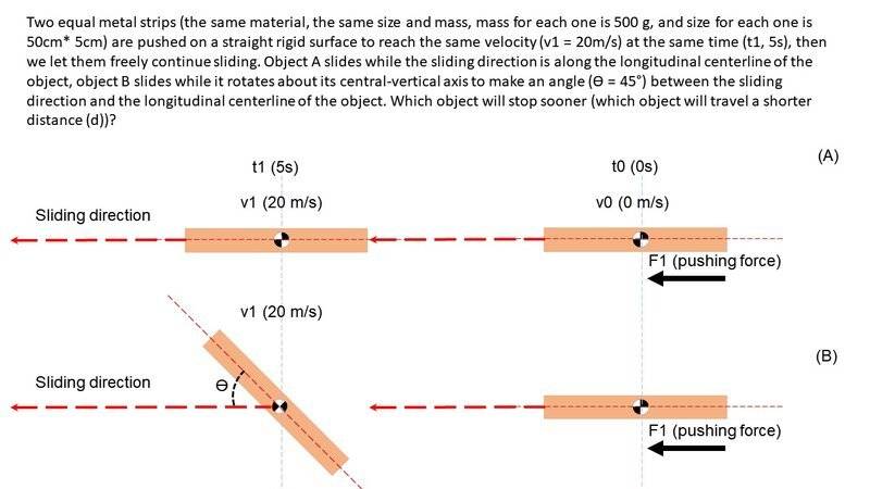

Two equal metal strips (the same material, the same size and mass, mass for each one is 500 g, and size for each one is 50cm* 5cm) are pushed on a straight rigid surface to reach the same velocity (v1 = 20m/s) at the same time (t1, 5s), then we let them freely continue sliding. Object A slides while the sliding direction is along the longitudinal centerline of the object, object B slides while it rotates about its central-vertical axis to make an angle (ϴ = 45°) between the sliding direction and the longitudinal centerline of the object. Which object will stop sooner (which object will travel a shorter distance (d))?

Well, work out your relevant equations for ##d## and there is your answer !

Assuming object B is initially not rotating and is accelerated by F1 acting through its centre, there is nothing to make object B rotate.
So what you are describing is physically impossible unless there is/are other force(s) you haven't mentioned.

so " d " for both would be equal, what is the effect of angle (ϴ = 45°) on d ?

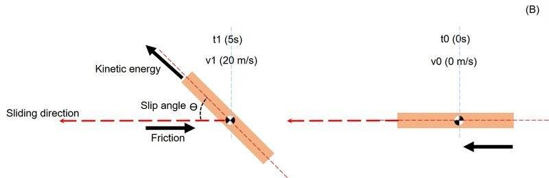

They are two separated objects, A and B, not two sides of one object. Object B reaches 45 degrees at t1 and then freely slides to stop, what is the effect of 45 degrees angle on duration and length of sliding?
If overall friction would be greater for case B than A, the metal piece simply would change its direction of travel to the path of less friction.
That is what makes the front wheels of a car roll in the steering direction rather than continuing moving forward (which only happens in very low friction conditions, like when asphalt is covered with ice).

@Javad, as an aside to the main discussion, note that the Post #11 attachment appears to say:
- object B rotates while it slides to a stop, which means angle θ is continuously changing (till rotation stops);
- angle θ = 45º, which is a fixed value.
Both can’t be true!
Both can’t be true!
No, actually object B rotates to reach angle θ = 45º at t1 and then continues sliding to stop (between t1 to full stop time angle θ = 45º is a fixed value.

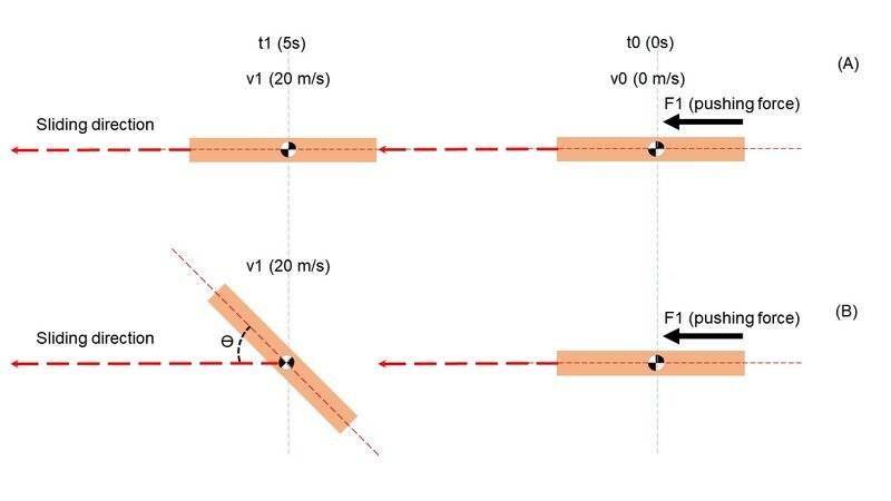

That is the whole point. It is friction (and only friction) which brings each object to a stop. The time to stop (and the distance covered) depend on friction.
Unless you compare the frictional forces on A and B, you can't answer the question.
Can you tell us how you can calculate the frictional force on A and the frictional force on B?

@Javad, the question is *entirely* about friction.
Can you tell us what course/level this is from?
Assuming it is an introductory level physics course, then you should remember:
- frictional force is needed to find acceleration (or deceleration if you want to call it that here);
- the acceleration is needed to calculate the time and distance needed to stop.
To answer the question you must compare the sizes of the frictional forces on A and B, There is no other way.
___________________________
Additional note
If you don't already know, you might also want to note that what happened before t1 is irrelevant.
At time t1:
- A is moving left at 20m/s oriented 0º to its velocity;
- B is moving left at 20m/s oriented 45º to its velocity;
- A and B are not rotating.
How the objects reached this state does not change how they behave after t1.

I am a latecomer to this so forgive if I show unmitigated naiveté. I looked at the photo in #11 and read all the posts trying to orient myself. This is what think is the physical picture
Strip A is the control strip. At t1 = 5 s its CM has a speed of v0A = 20 m/s and it travels with its length along the x-axis until it stops.
Strip B is the subject strip. At t1 = 5 s its CM has a speed of v0B = 20 m/s along the x-axis while its longitudinal axis forms angle θ = 45° with respect to the x-axis. Its CM continues traveling along the x-axis while the rest of the strip rotates about its CM until it stops at some angle relative to the x-axis.
I base this interpretation because (a) the photo clearly has a time stamp of the two strips with the same velocities and different orientations; (b) angle θ is clearly labeled in the diagram and the text clearly mentions that θ = 45°; (c) the text mentions that the strips got to their respective orientations under the influence of the forces driving them ". . . then we let them freely continue sliding. Object A slides while the sliding direction is along the longitudinal centerline of the object, object B slides while it rotates about its central-vertical axis to make an angle (ϴ = 45°) between the sliding direction and the longitudinal centerline of the object.
The text in red is where there might be room for interpretation. Clearly, the sentence that begins with "Object A ##~\dots~##" describes the situation after we have let the strips to slide freely. Clearly, the text mentions that object B slides and rotates after the strips are allowed to slide freely. Clearly, the angle labeled θ at time t1 in the photo is given the value of 45° in the text. Putting all this together I concluded that, at time t1, strip B is translating while rotating and forms an angle with an instantaneous initial value of 45° relative to the x-axis. An alternative interpretation could be that at time t1 the initial angle is some θ as shown in the photo and the final angle is 45°.

Two equal metal strips (the same material, the same size and mass, mass for each one is 500 g, and size for each one is 50cm* 5cm) are pushed on a straight rigid surface to reach the same velocity (v1 = 20m/s) at the same time (t1, 5s), then we let them freely continue sliding. Object A slides while the sliding direction is along the longitudinal centerline of the object, object B slides while it starts with the sliding direction along the longitudinal centerline, and during t0 to t1 it gradually rotates about its central-vertical axis to make an angle (ϴ = 45°) between the sliding direction and the longitudinal centerline of the object, and with the fixed angle (ϴ = 45°) it continues sliding. Which object will stop sooner (which object will travel a shorter distance (d))?

Hi@Javad. It would be clearest if the motion were described in time-order.
From t=0 to t1=5s: A is accelerated to 20m/s aligned as shown and B is accelerated to 20m/s while rotating.​
At t1=5s: B stops rotating with θ=45º as shown; the accelerating forces are removed.​
After t1=5s: A and B slide (with B’s angle θ=45º constant) and come to rest.​
Is that correct?

I think due to mass and fast rotation (that happens for object B), object B experiences inertial pulls in the opposite direction of rotation at the center of mass thus the object would have the tendency to skid towards the opposite direction of rotation (probably it is the actual heading direction), while there is lateral friction for object on the opposite side, therefore if the skidding force be greater than the lateral friction the object can slide but there is a waste of energy (velocity or force, actually I don’t know what!) in comparison with object A. (Please find attached image).
