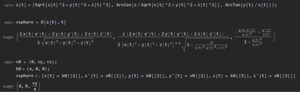

Hi all,
I can't find a single thing online that translates a cartesian velocity vector directly to spherical vector coordinate system.
If I am given a cartesian point in space with a cartesian vector velocity and I want to convert it straight to spherical coordinates without the extra steps of calculating things such as theta or d_theta/dt .
Looking at the wiki I have a few problems:
https://en.wikipedia.org/wiki/Vector_fields_in_cylindrical_and_spherical_coordinates
I tried using the first matrix formulation in the spherical coordinates section to get my spherical coordinate vector in terms of x,y,z.
Then I take the derivative with respect to time of this to find the spherical velocity vector with respect to x,y,z, dx/dt, dy/dt, dz,dt.
I input a location in space with only an x value {a,0,0} and a cartesian velocity with only y & z components {0,vy,vz} at this cartesian location.
I would expect that a this is like being at the equator of a sphere with radius a so we'd have {a, Pi/2, 0}. Then a velocity in the y and z direction only corresponds to a velocity in the -Theta and -Phi direction.
However, I am only getting a +Phi direction. What's going wrong here?
Additionally, in the wiki article, the last equation for Adot has the terms Ar_dot, Atheta_dot, & Aphi_dot. But doesn't give any formulation for them. From what I understand, perhaps what I did above is just fine r_dot, theta_dot & phi_dot. But then where are the Adots?
Nevermind!
Looks like I missed a simple mistake in my original formula for s[t]. I did not have a [t] on the z[t] for the theta term.
I believe it works now.
Although the wikipedia page is still too convoluted to help anyone
Do you think you can figure out how to express the Cartesian unit vectors in term of the unit vectors is spherical coordinates?
