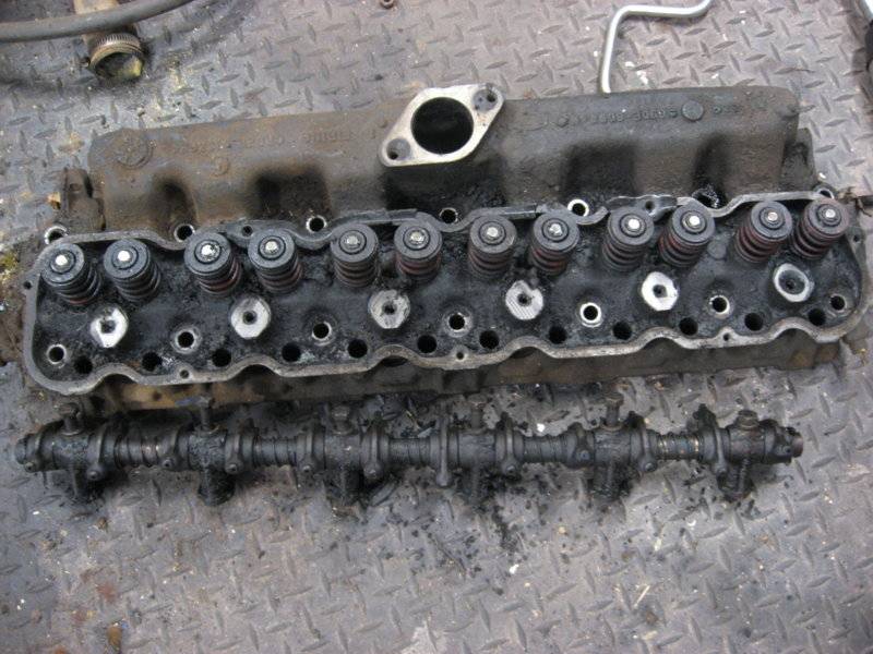

I have a 1973 Ford 200" six to replace the same size engine in my 1965 Mustang. The .060" overbore in the original engine is too much making the walls too thin. It works but hard starting when hot, so I got a newer 200. The intake is cast with the head so the intake manifold can be a problem.
Some machine the manifold for a 2-barrel which works fine but costs about $500.00 to $800.00 not counting the valve job. I am not looking for maximum HP but Torque. My cam is designed for Torque in the 1500 to 3000 rpm range which is perfect for my purpose. The intake opening on the 73 is 1.75" while the 65 is 1.5" so I have a 1/4" bigger to start and the valves are the same as the 65.

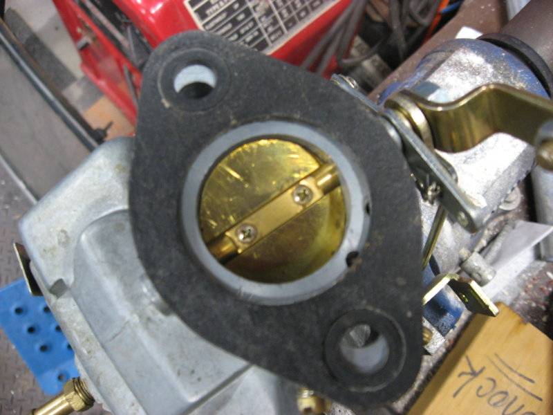

Thinking "velocity" and not volume, it appears the Autolite 2100 carb at 287cfm should work well with the later head by only being adapted and not machined to fit direct on the intake. The carb worked fine adapted on my 65 with the 1.5 opening so the 1.75 should allow better flow into the manifold just using a bigger adaptor which is available.
The small valves may offer a venture effect into the combustion chamber, the Autolite has annular-atomization for better fuel vaporization, I built a cool-air intake for better combustion, along with a hotter ignition and better timing. As an old 1960's - 80's engine builder, is my thinking correct?
The slightly larger intake opening is ample for improvement of air/fuel flow, and the same size valves (smaller than later head) could help velocity into the chamber?
The older head is 1100 cfm and the 73 is 1240 cfm while the OEM 1-barrel was 1100 cfm and the 2-barrel I use is 287 cfm. This carb on my old engine got 24.5 mpg without the cool-air intake on a 2,275 mile trip running the air conditioner all the way, hauling 2 corn-fed adults. The carb adaptor mounts the 2-bbl to the 1-bbl manifold with a funnel style reducer.
Because the 73 manifold has a 1/4" larger opening and the volume is 1240 cfm as opposed to the 1100 cfm original, is my thinking in line with air-flow?

The larger intake volume will raise slightly your low-torque rpm range. If the valve ports and camshaft stay relatively the same, you shouldn't see any change in top-end power.
Note also that the 73 combustion chamber is larger (62 cc vs 52 cc), which means your compression ratio will go down unless you do some modifications, thus losing power and increasing fuel consumption.

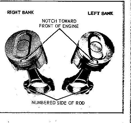

Ahh the 60s! As you can see the flat top pistons of 1965 were replaced with deep dish pistons that dropped the CR biggly!
hope this helps
i had to go back and get the cam lift specs..odd that 1973 had slight increase in the bump but lower duration to meet EPA specs. plus unleaded crap Gasoline back then

The 65 six piston had 6.5cc dish while the 73 had 13cc with a slightly different cam, though I have seen those cc numbers reversed... hello INTERWEB INFO! The head chambers are 51cc for the 65 and 62cc for the 73. With those numbers the 1973 compression is about what old tractors had when they could be hand-cranked. The pistons in the picture are V8 pistons, while mine are dished in a circle with no valve relief cuts. Info on-line SUCKS and is wrong about half the time. You guys seem to be accurate-freaks...in a nice way...and truly seem to want to help. Because I answer questions about the early Mustang 6-cylinder on-line, to guys who are not long-time Hot Rodders, I need facts they can trust. There comes a time when some ask where I got my info, and can they trust it? This page gives tech answers with references I can quote and/or pass on for them to check personally. I have tech references from the 1960's thru 1990's and it is good, but newer is better with the changes to the internal combustion engine seen in the last several years. A double OHC cross-flow head with 2100 carb on a nice (best length runners for MPG), hot non-computer ignition, tuned exhaust and tied to a 5-speed or non-computer controlled overdrive automatic, could get well into the 30's MPG. Match the right rear gears and tires with a lock-up converter...it may sound wild, but high 30's could be possible with no computer. It would run clean also. The Mustang 6-cylinder is rare for the 65-66 year compared to the V8...roughly 0ne-in-four. So, if a guy messes up the machine work, a new motor is hard to find, while 260, 289, and 302's can be purchased at the local 7-11. Okay, I exaggerate, but you get the idea. I hope I am not taking up too much of your time on this subject, but I learned years ago, if I do it on paper first, things seem to work better in reality.
